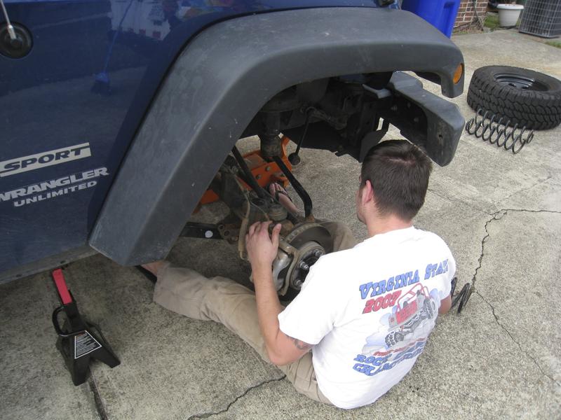

The first time I did this lift, I had the jack like you did, and I remember having to use coil compressors to remove/insert springs. The second time I did the lift (when I sold it to a friend), we had the jack under the center of the axle, and it worked soooooo much better -- no coil compressors required for removing the springs, although we had to be creative on inserting the new ones (by not doing the bumpstops first).
Honestly, I thought the jack placement was what made the difference the second time, but maybe he had something weird going on with his brake lines that helped too???

If it helps motivate at all, here's a pic of the jack towards the center of the axle (that's my buddy in it), and a pic of the finished JK (with the owner in it).

I got it out. I had to manipulate the brake lines, and it was a tight squeeze but I got it. Getting it back in may be another story!

Cool! And yeah, getting it back in is more difficult, esp if you fully insert the new bumpstop before you try to put the new coil back on!!!
