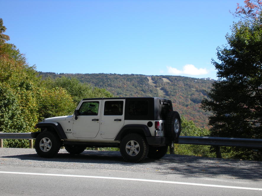

Thanks for the measurements. I am looking at this lift also. Any issues? How is the lift with 16's? A lot of air between tire and fender? Any pics of you setup? Did you need to do anything else? Control arms, trac bar, brake lines, bump stops??? Any driveshaft issues? Side note, how do you like yours tires? Thanks again.

I have had no issues with the lift. My Jeep looks stock with the lift and 255/85 16. I am not building a rock crawler, I am more interested in an overlanding vehicle. The only thing that I did in addition to the lift was making some brake line extensions. I really like the tires. I have about ~6,000 miles on them with a lot of highway miles including a 24 hour round trip to Snowshoe, WV. They have been great on the road and off road.
