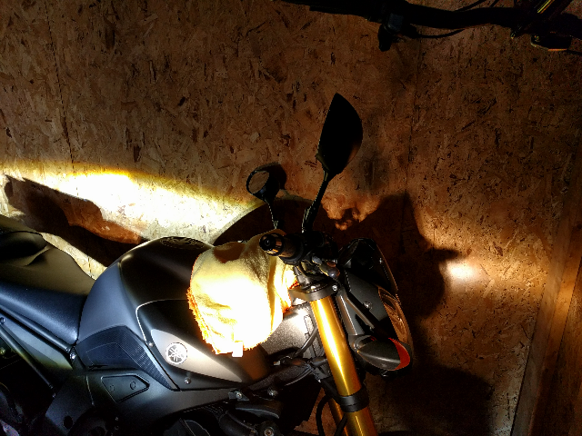

Only issue I have is that when seated in the notches, my driver side bulb is rotated counterclockwise about 5 degrees. Nothing major but it sparks my OCD.
You can see light color differences between stock and Ignite on the wall behind my bike. Will take night shots this evening.

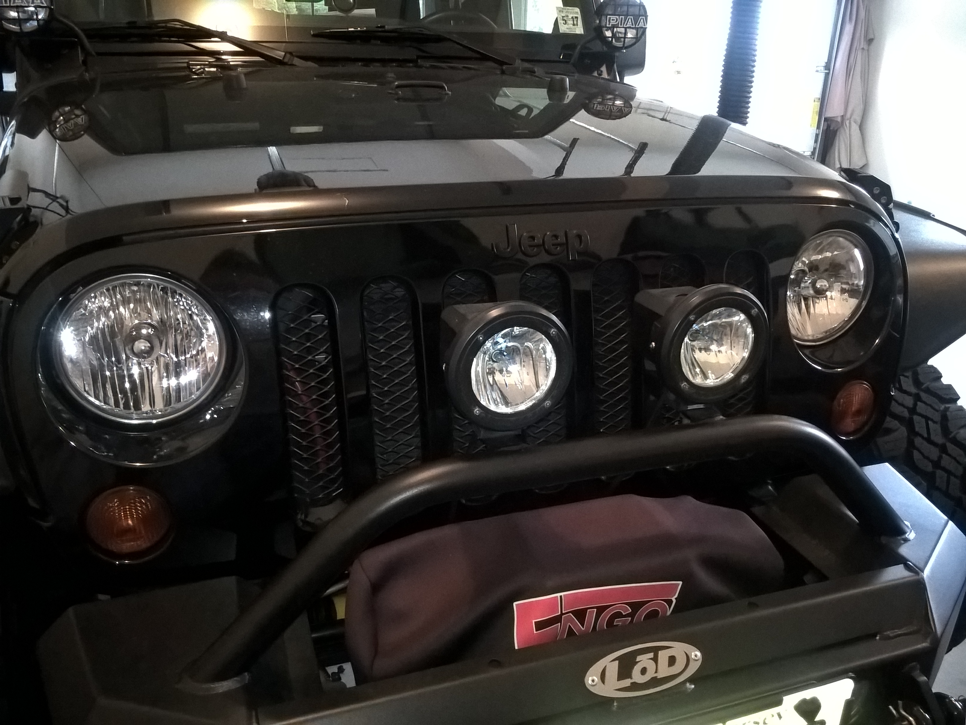

Quick Write Up on the Trail-Flame 7" LED Headlamps with DRL:
I installed the lights yesterday on my 2012 JKU with no major issues. Overall, very pleased with the instructions and quality.
Total Time: 2-2.5 hrs +/- (depending on if DRL is completed same time)

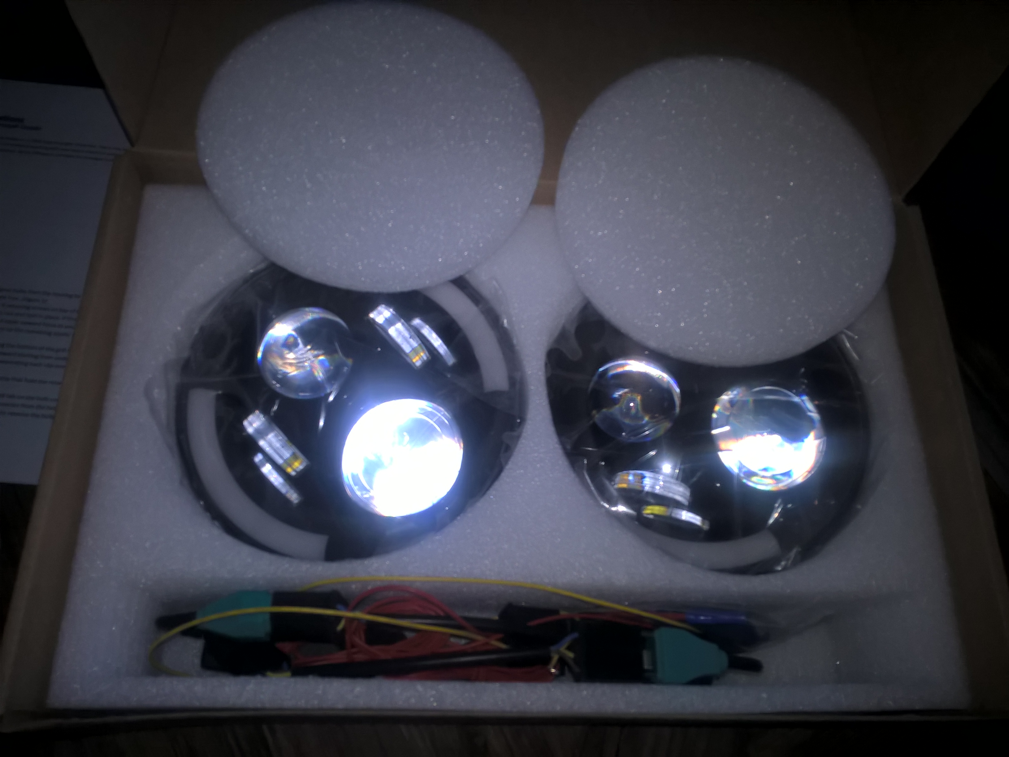

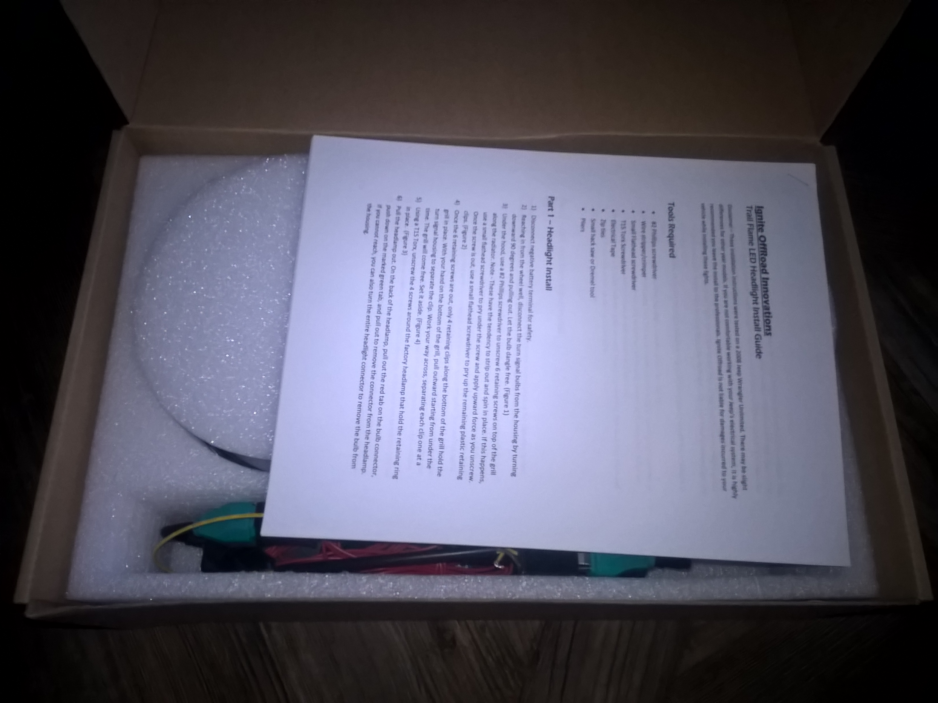

Packaging:
ID:	633461 Click image for larger version

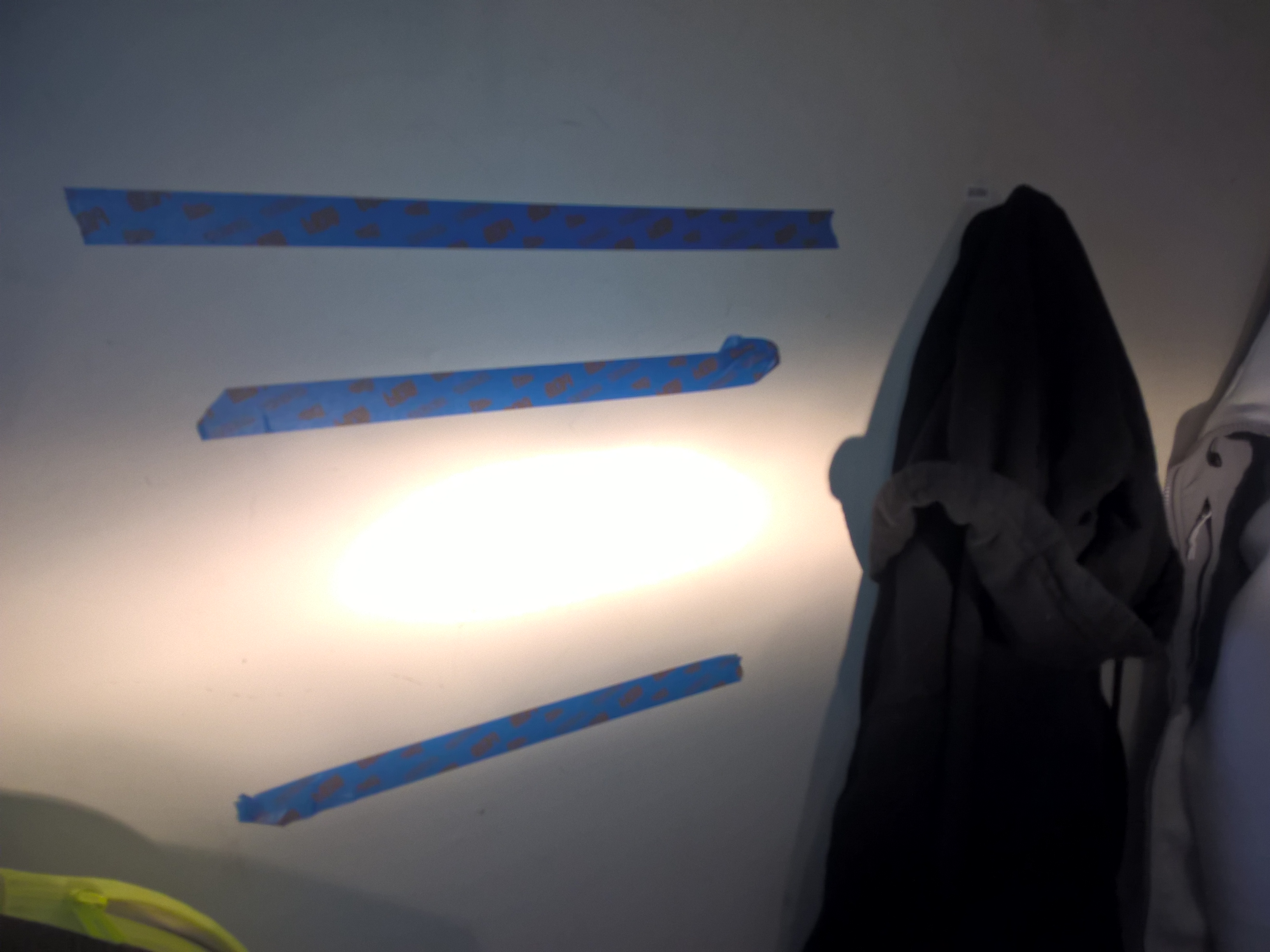

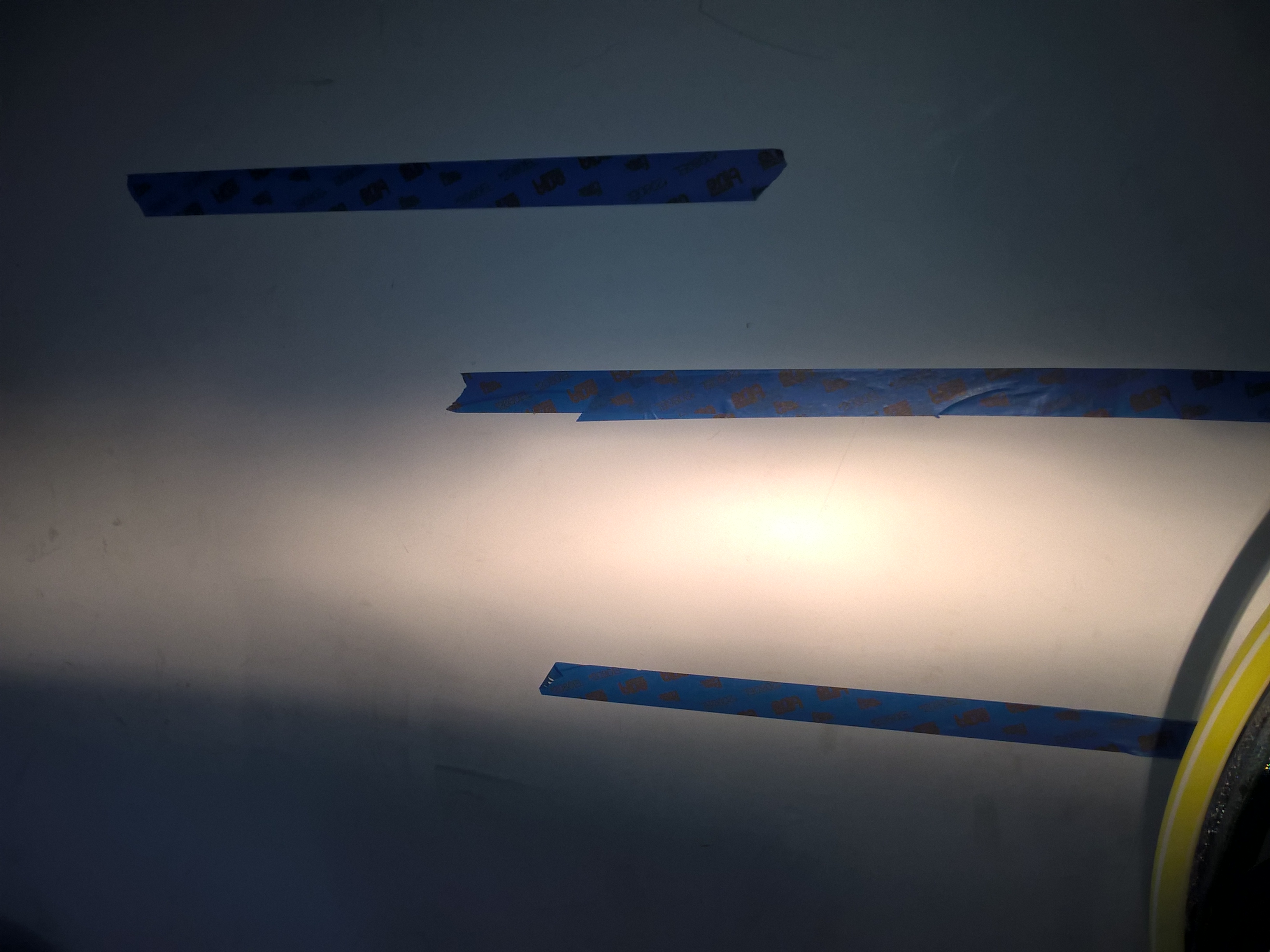

1. Marked off current lights:
I started off first, marking off my lights on the garage wall with painters tape to compare the height and alignment after completion. Not sure if this is helpful, but did allow me to recognize if the lights needed adjustment afterwards.

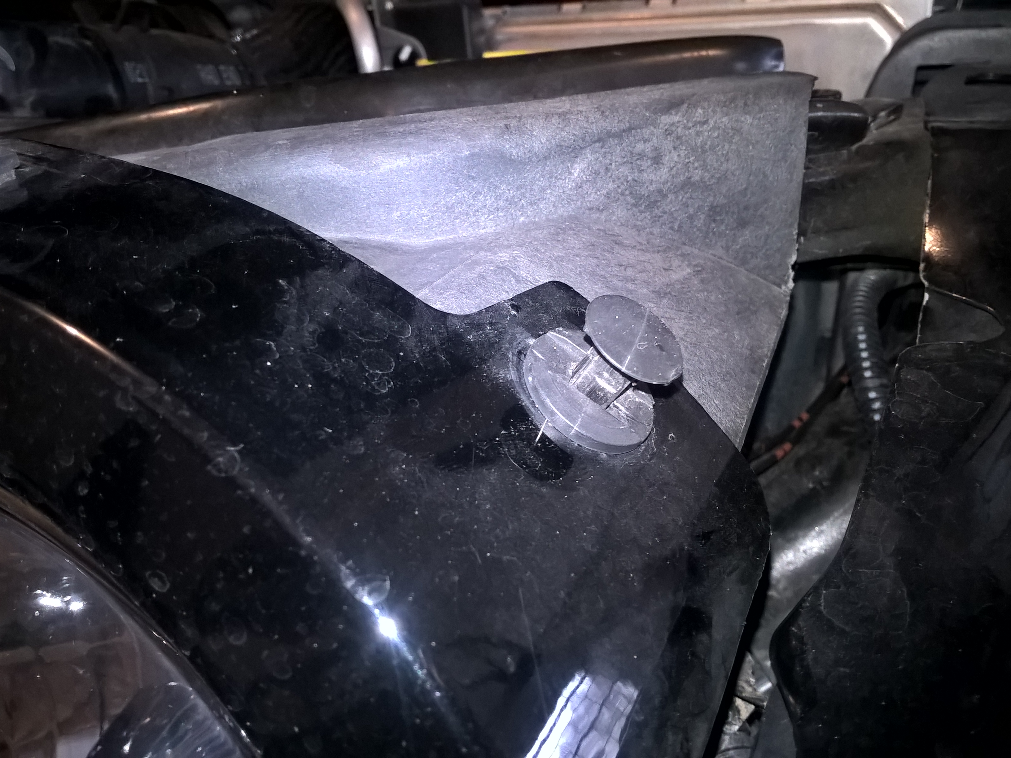

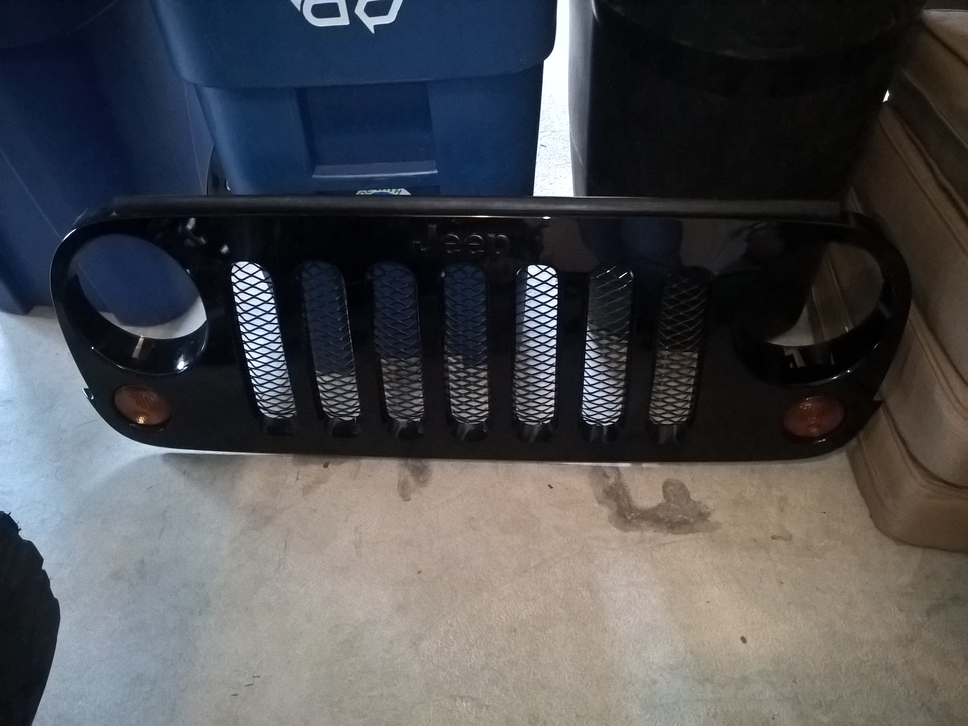

2. Remove Grill
Disconnected the front parking lights by turning about 1/2 an inch as instructed. The instructions call for a screw driver to remove the tabs on the grill. My 2012 JK tabs only required a tab removal tool or a small flathead screwdriver:
ID:	633465 Click image for larger version
ID:	633466 Click image for larger version
ID:	633467 Click image for larger version

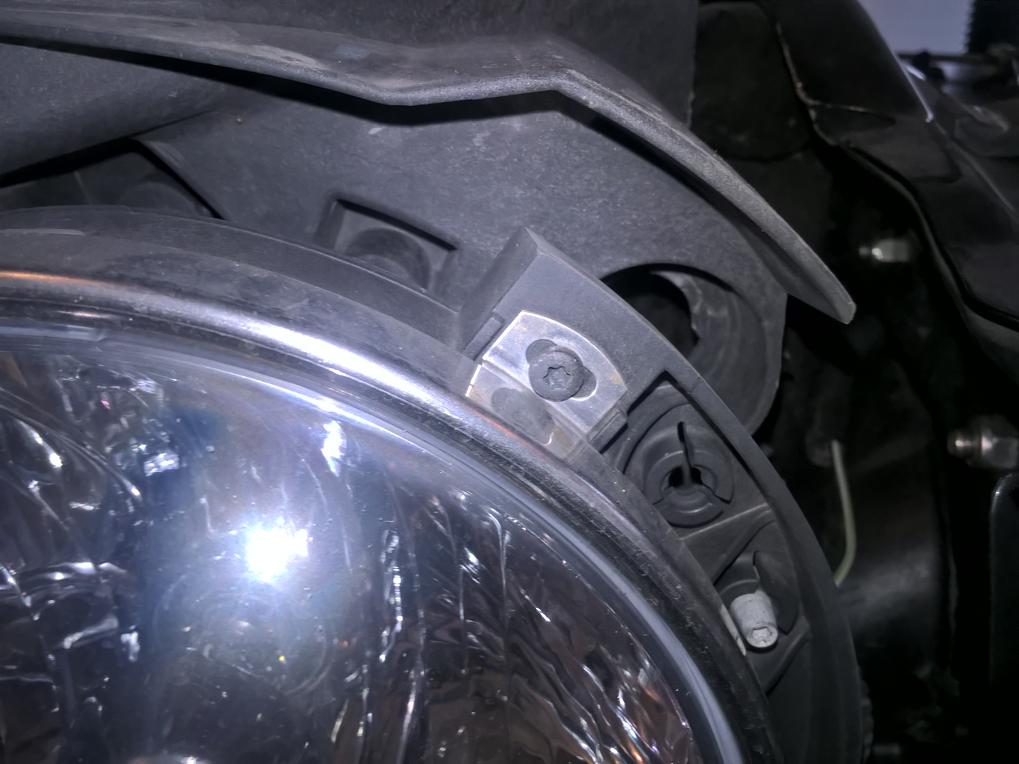

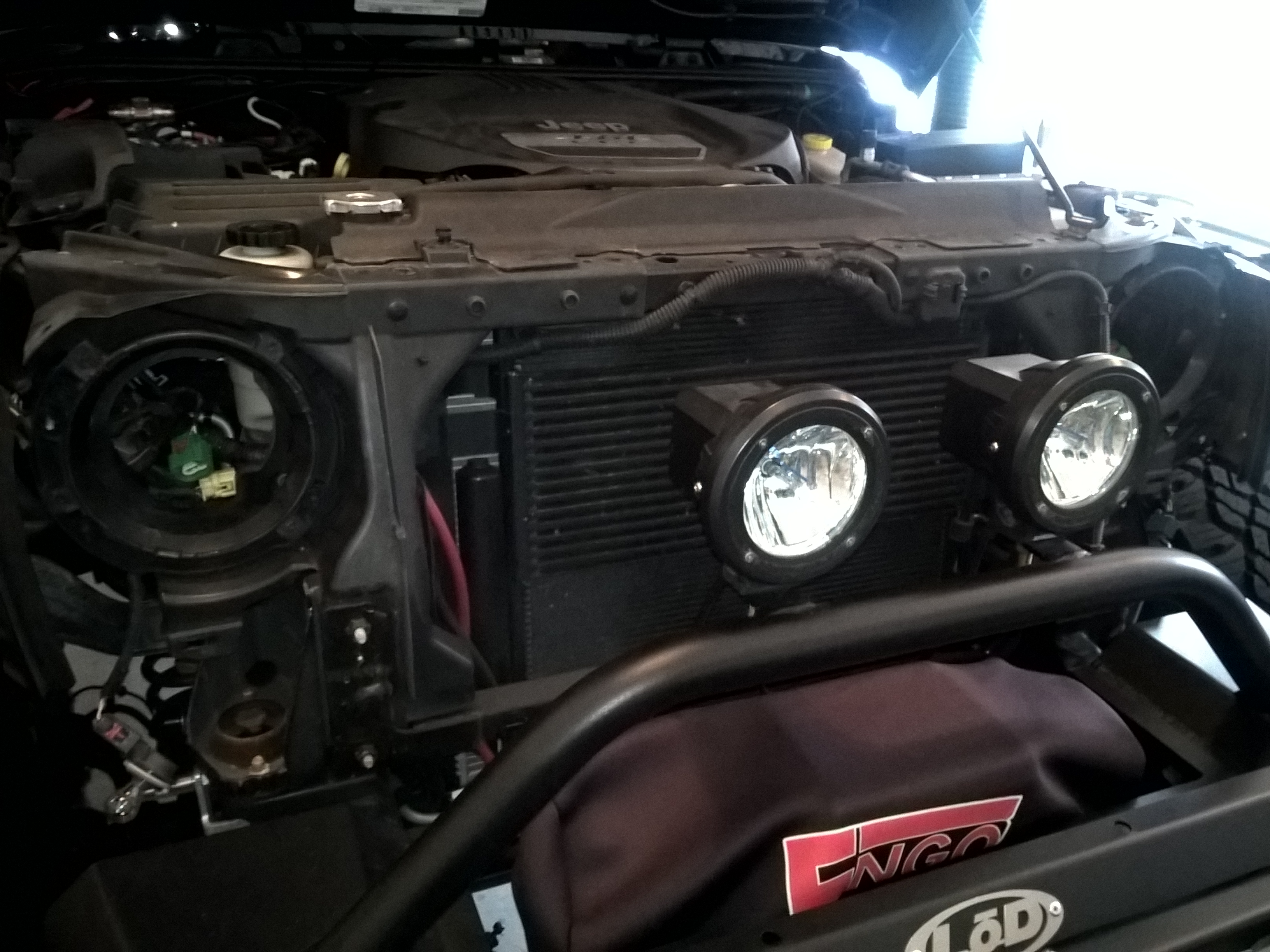

3. Remove Headlights
NOTE: I used removal as an opportunity to PAINT the chrome light bracket BLACK. Sanded it down and sprayed one quick coat of a textured black I used on my rails.
ID:	633471 Click image for larger version
ID:	633472 Click image for larger version
ID:	633473 Click image for larger version

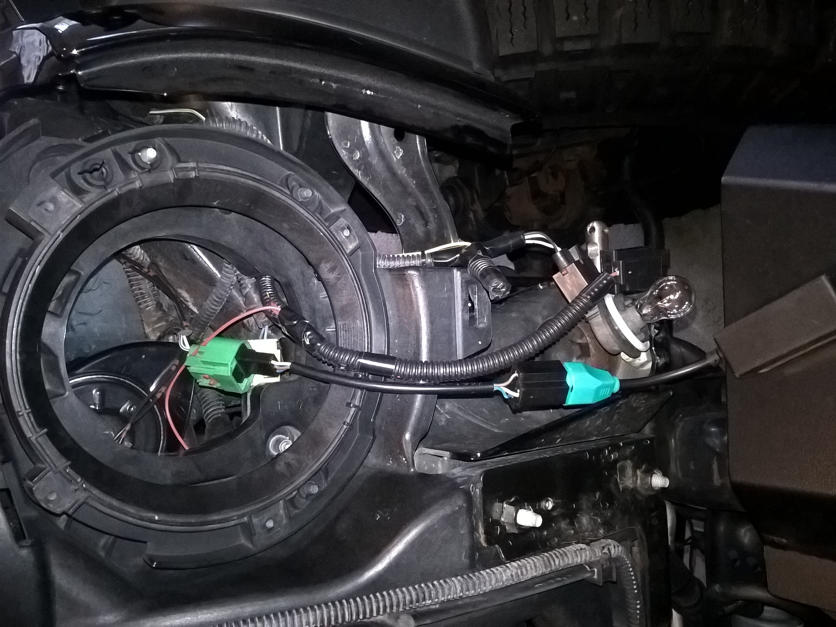

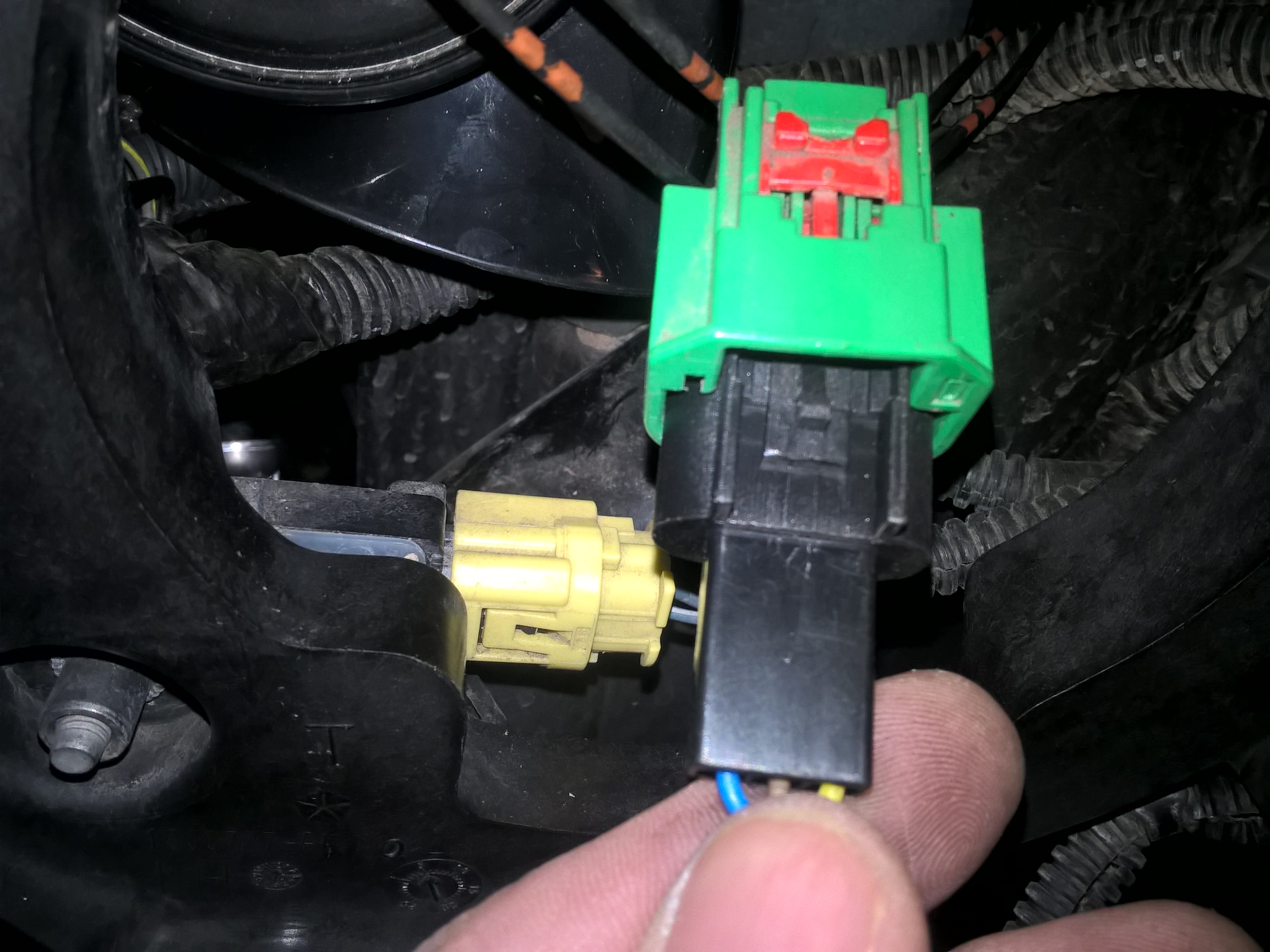

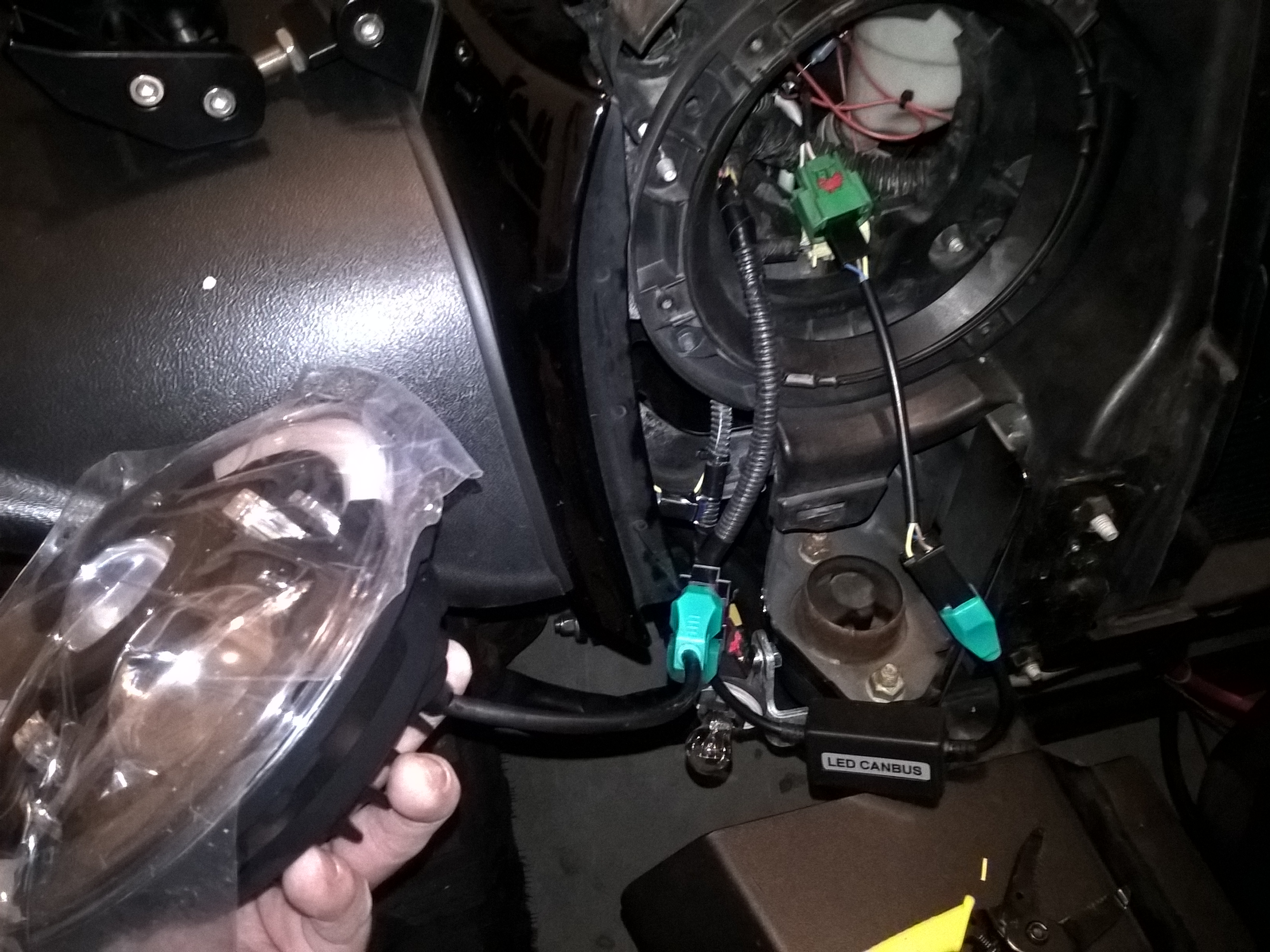

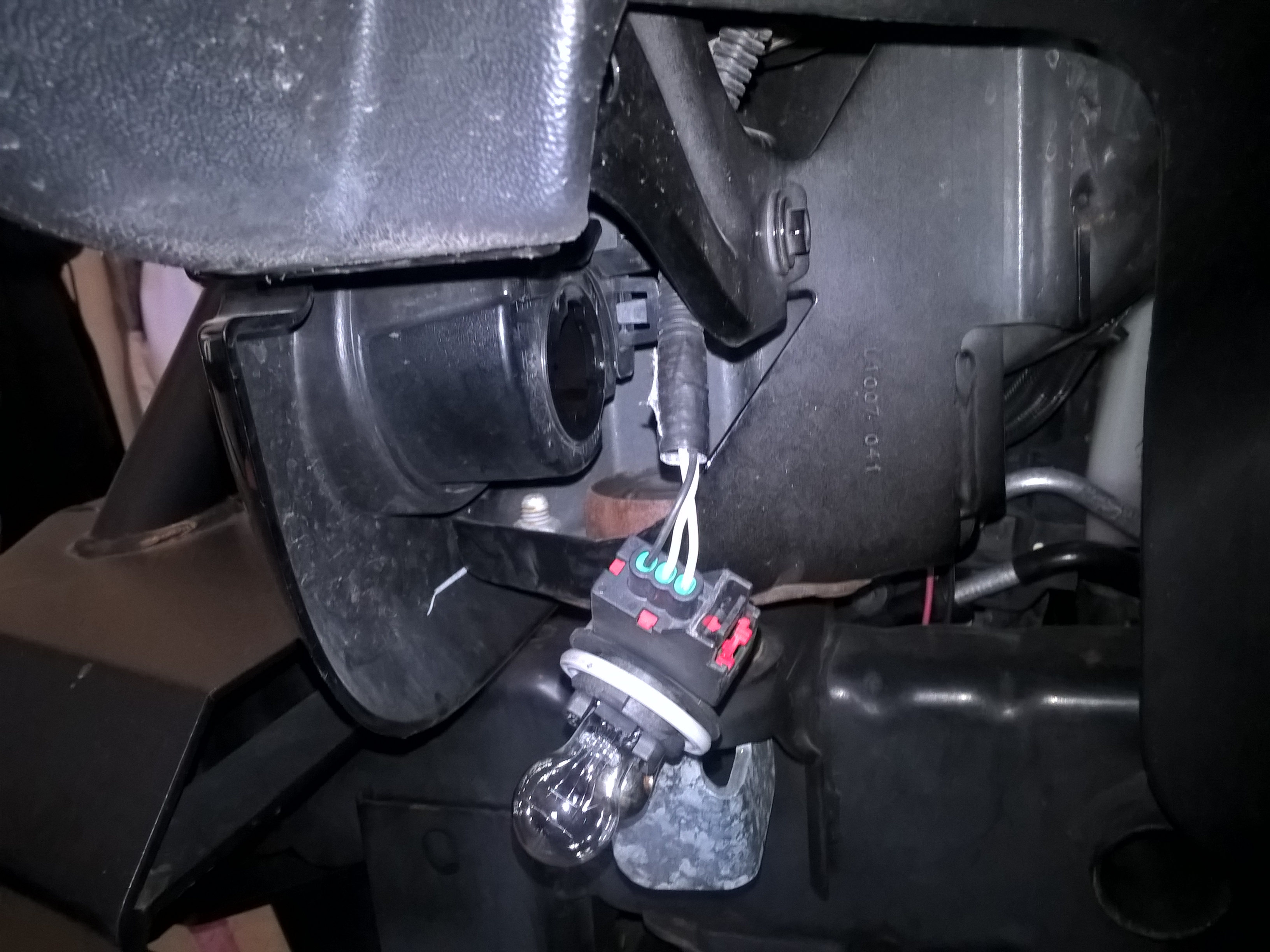

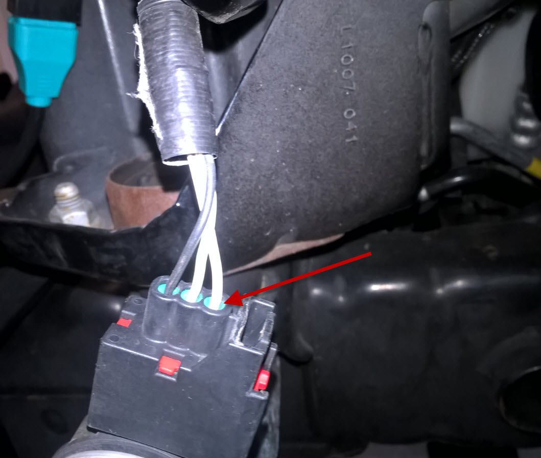

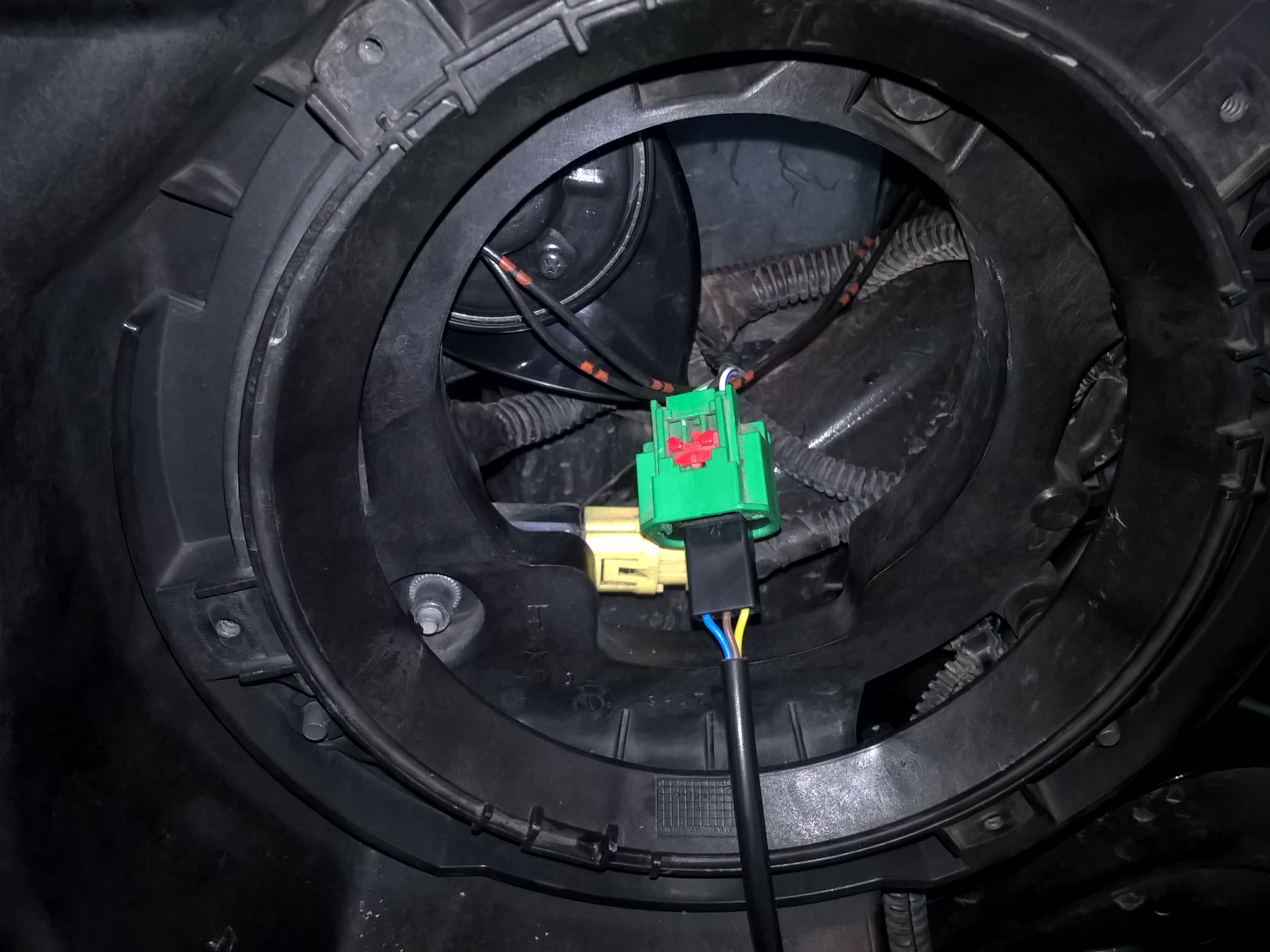

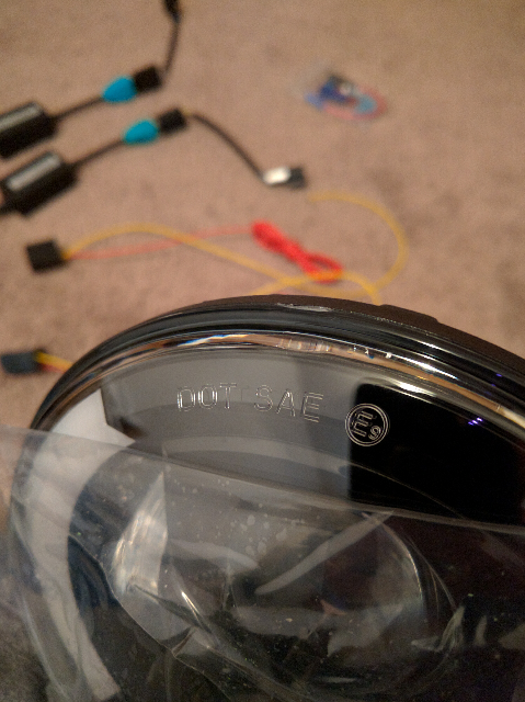

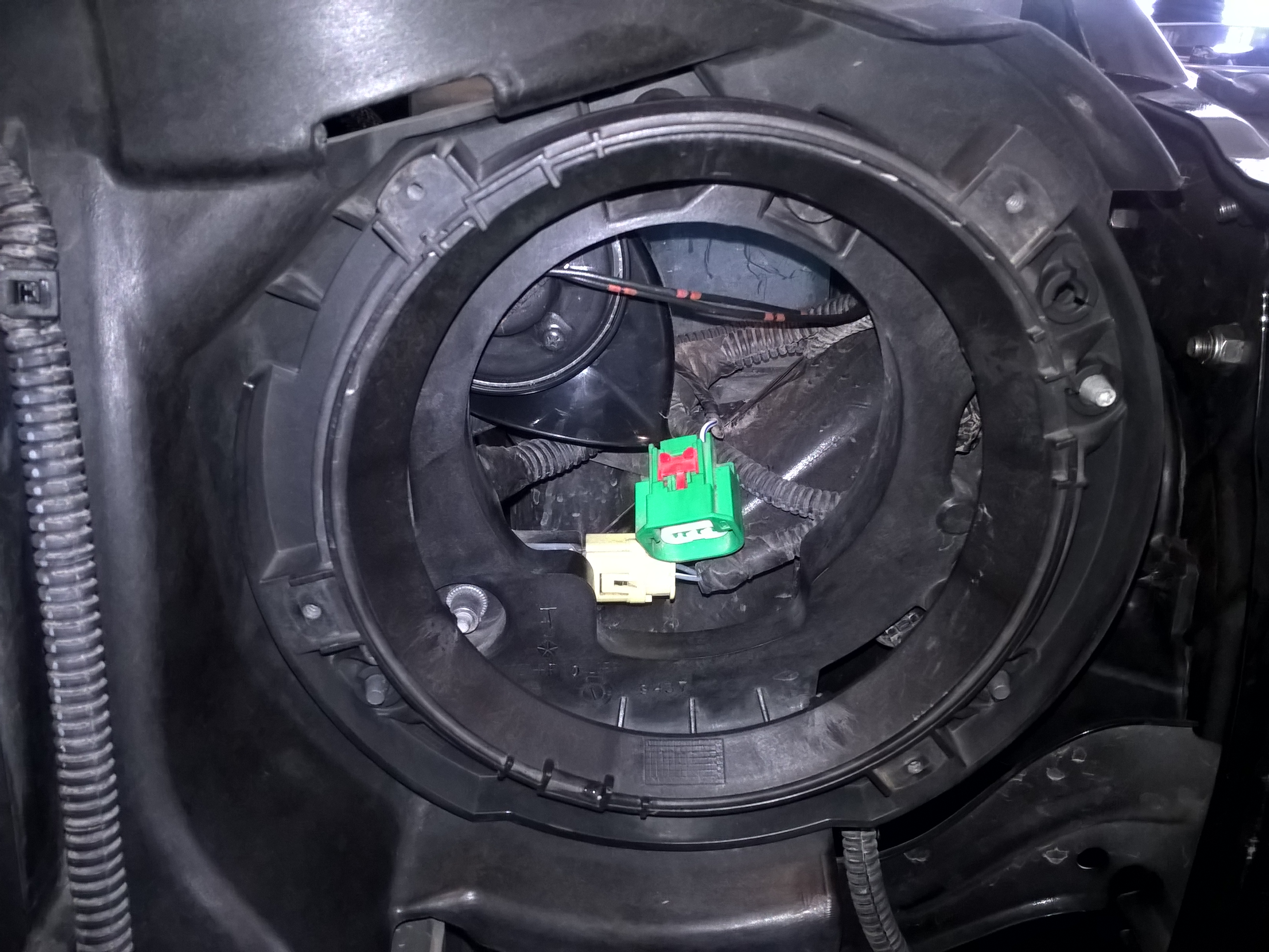

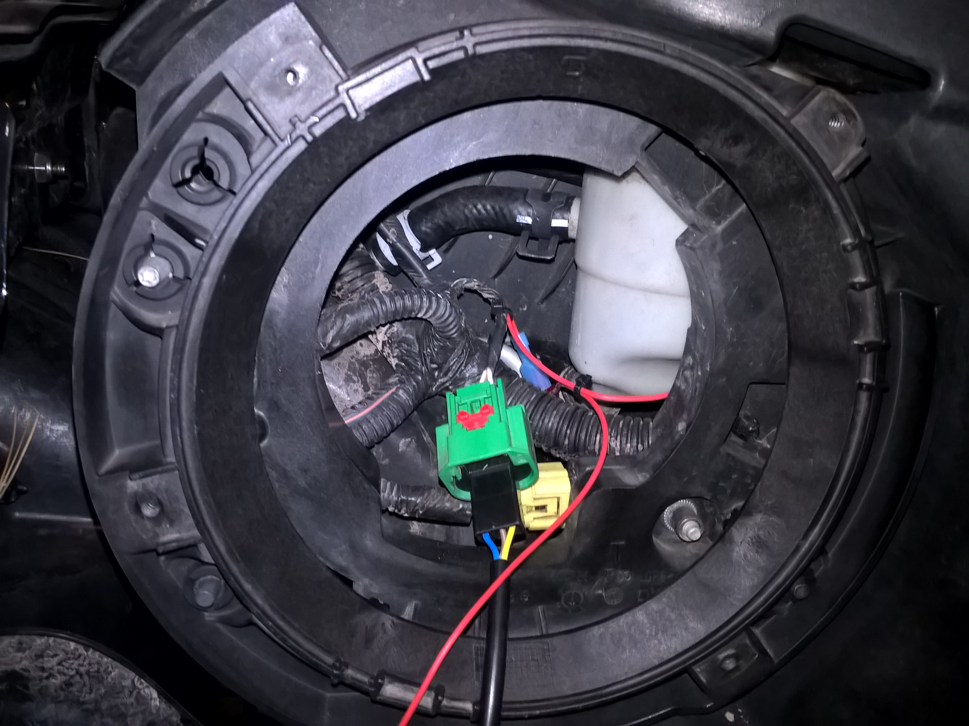

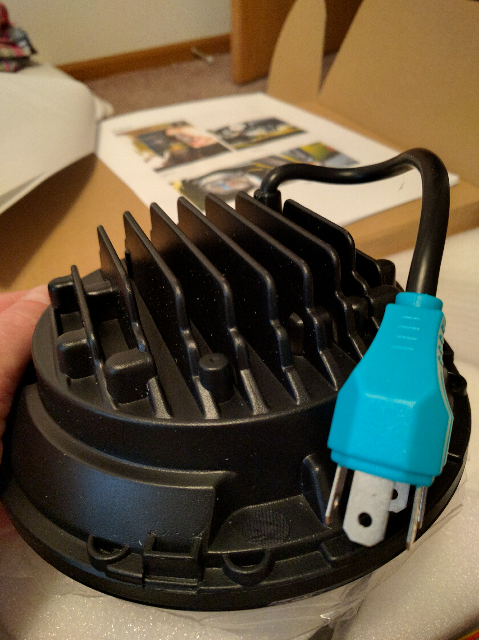

4. Plug n Play Headlight Adapter

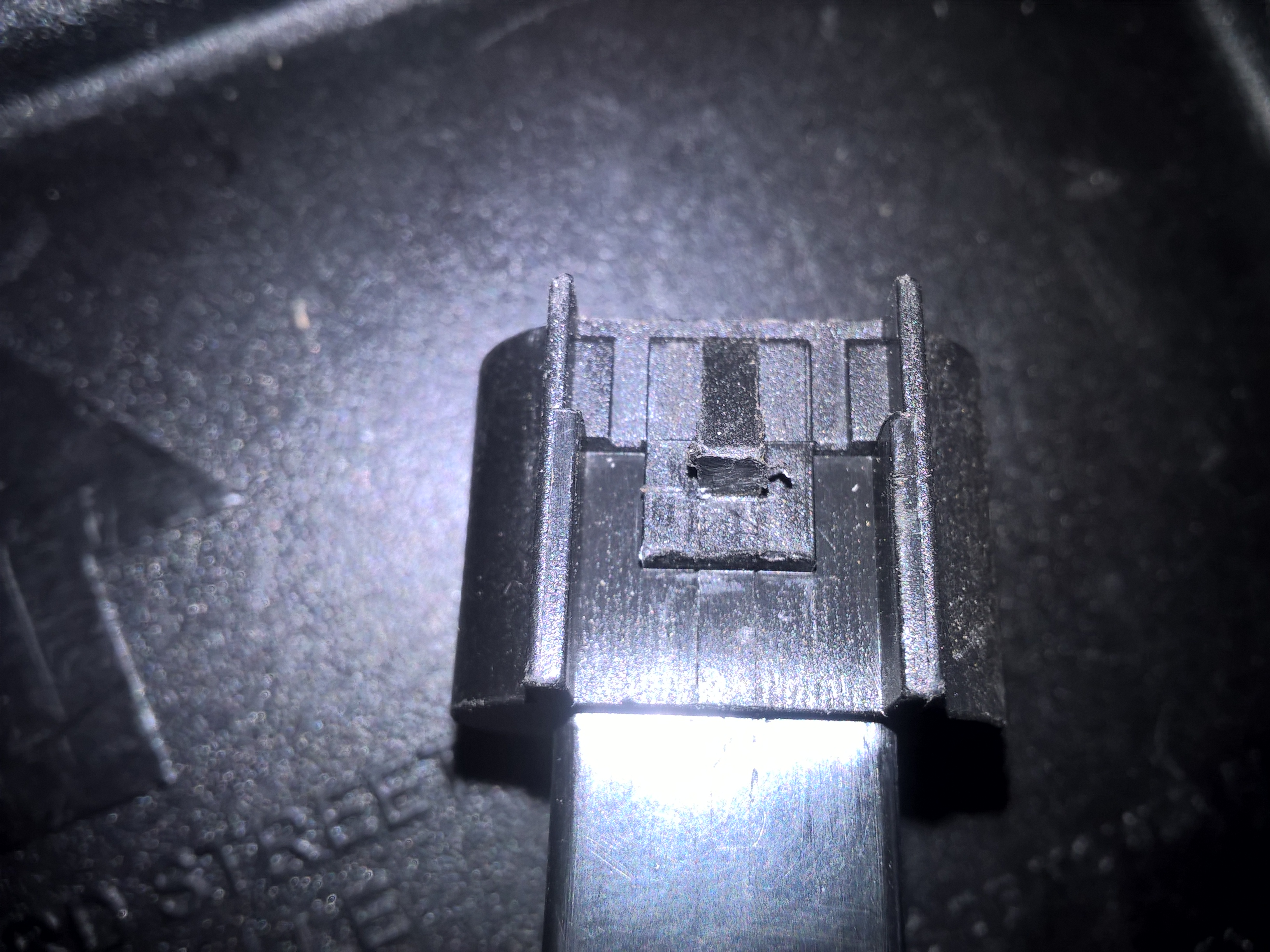

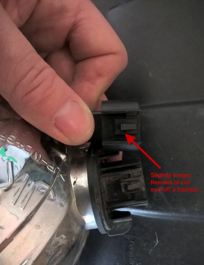

NOTE: So, I did run in to a very minor issue at this point. The plug that connects to the OEM headlight didn't snap in place properly. After close inspection in the adapters on the tab were not cut properly and required a minor trip with a razor knife. This really was the only issue that I ran into. Once I figured it out it fit perfectly. Curious if this happens to anyone else:
ID:	633476 Click image for larger version
ID:	633475 Click image for larger version
ID:	633477 Click image for larger version

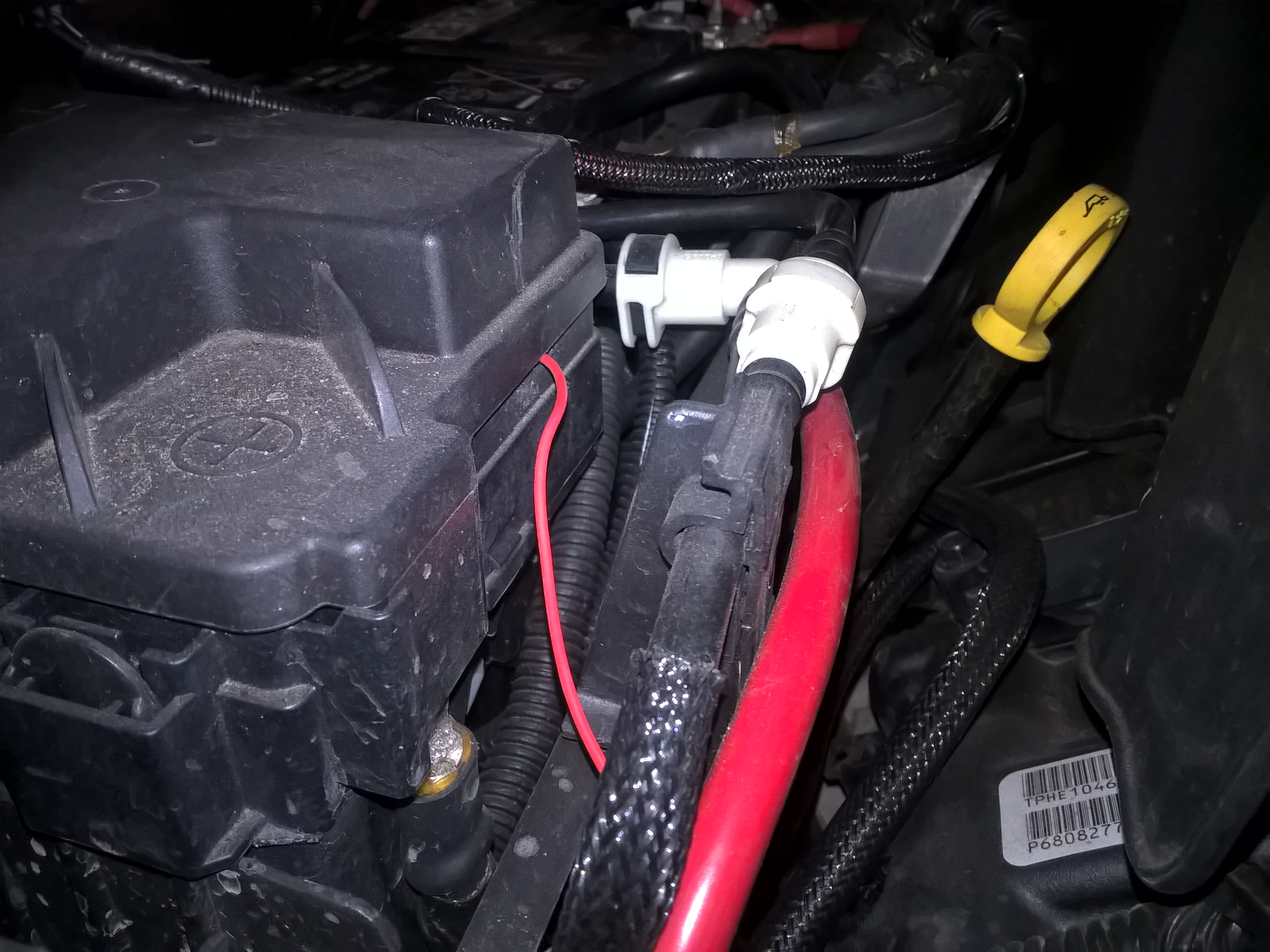

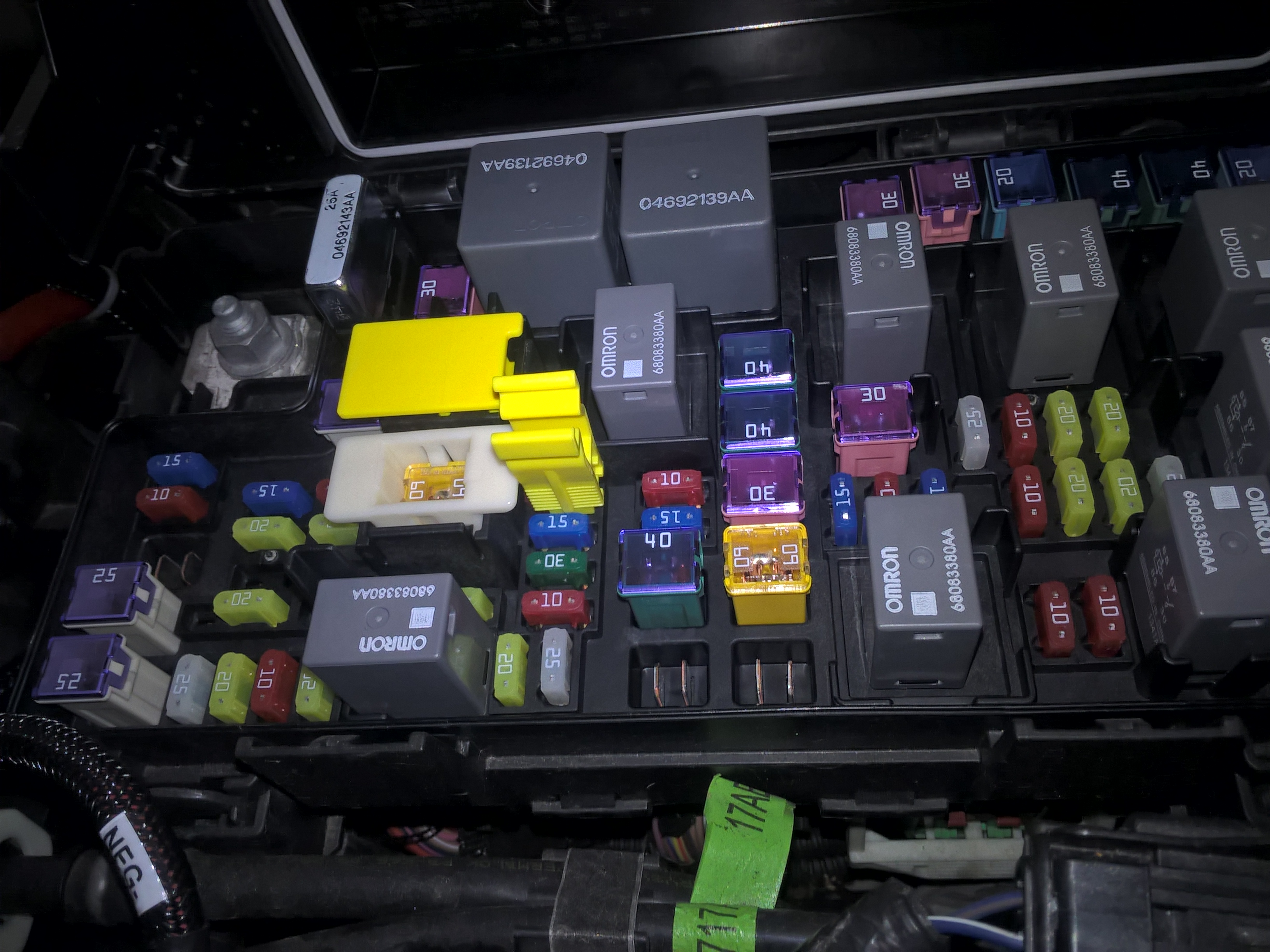

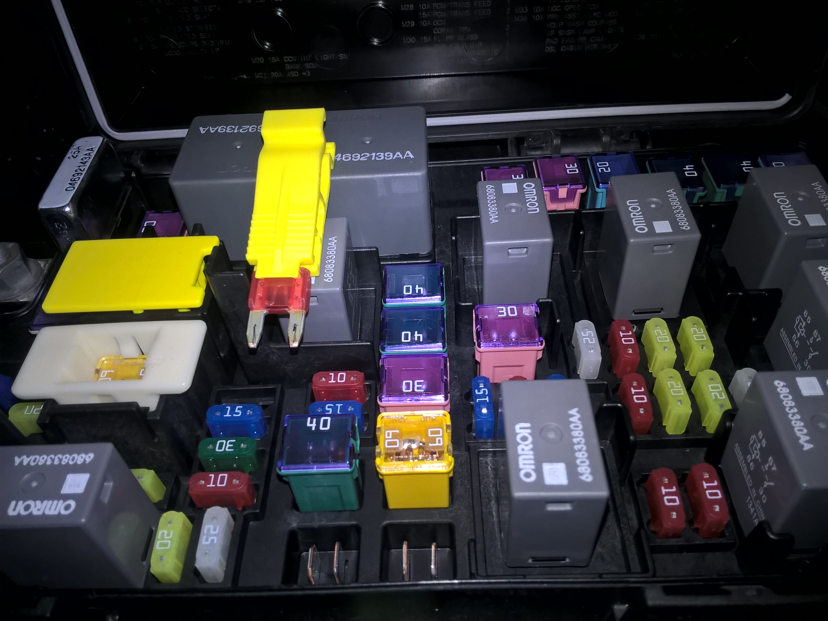

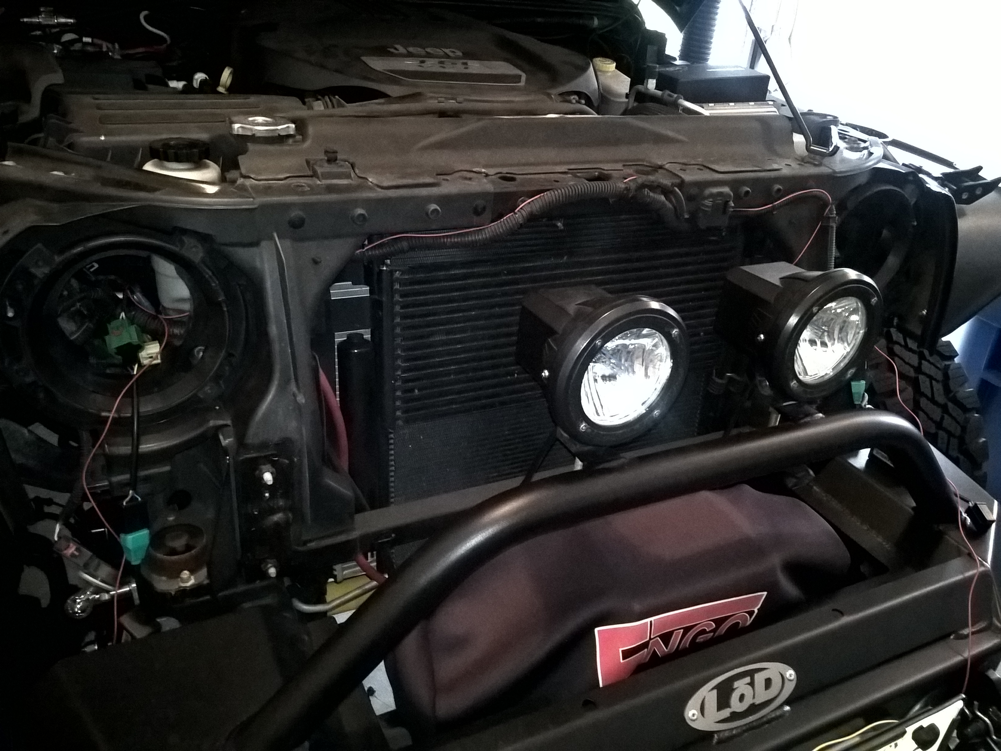

5. DRL Wire to Fuse box
This is an optional step if you want to wire up the directional lights.
I used fuse M37 as stated in the instructions. FYI - The location of the fuse is inside of the fuse box lid which was different than the pictures provided since I have a 2012. I then used a small hacksaw to notch the right side of the box to route the wire to light assembly.
NOTE: The instructions call for crimping the RED DRL wire to the supplied fuse adapter. I did that first and then realized that I had a lot of excess red wire once routed. Before crimping route the wire from the passenger light to fuse box, and then cut any excess off. Its an OCD thing for me.
ID:	633479 Click image for larger version
ID:	633480 Click image for larger version
ID:	633481 Click image for larger version
Driver Side:
You will need to route the RED DRL wire from the Driver side to tap into the Passenger side. I tie wrapped the wire to the loom that travels across the grill area:

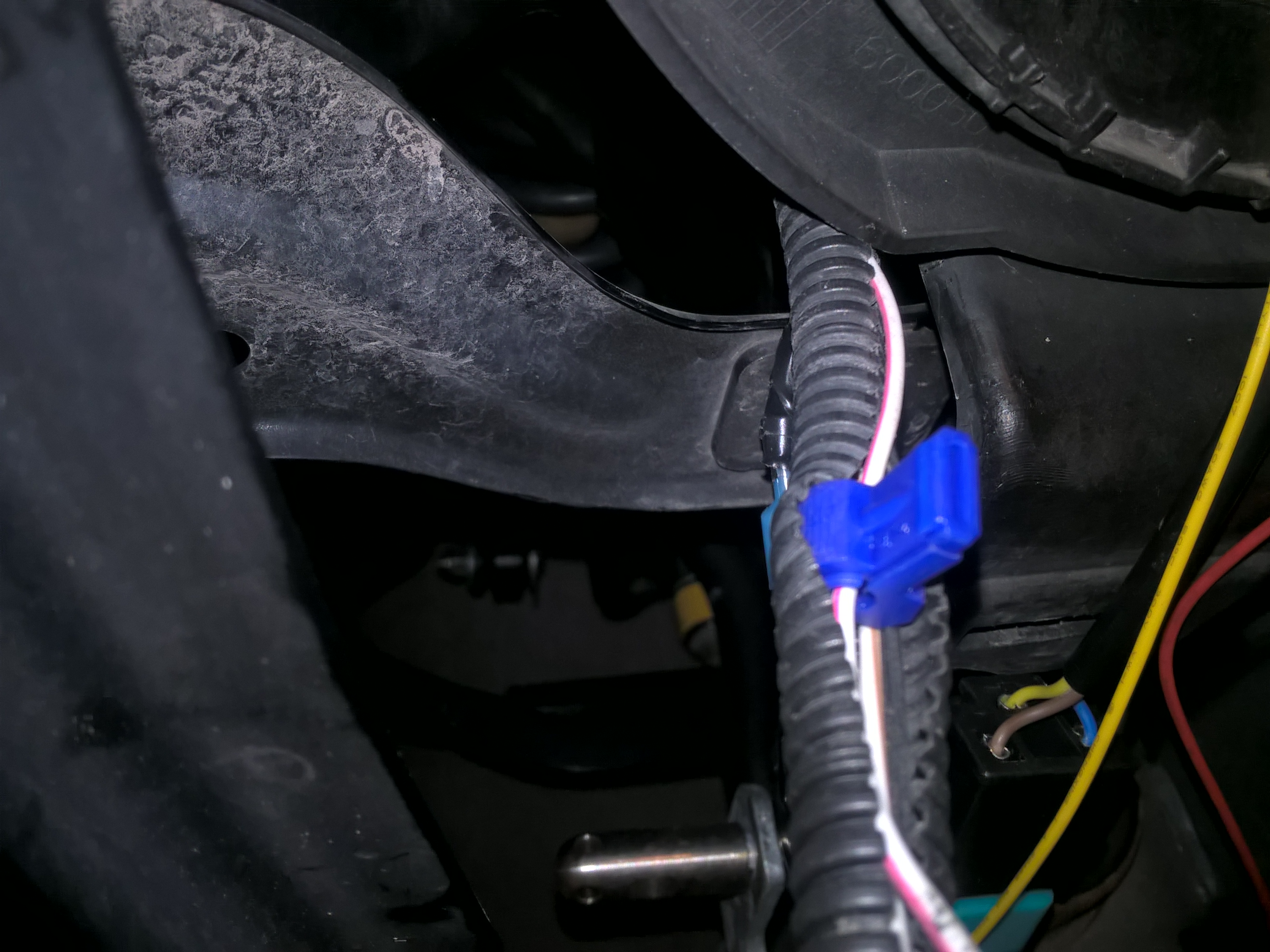

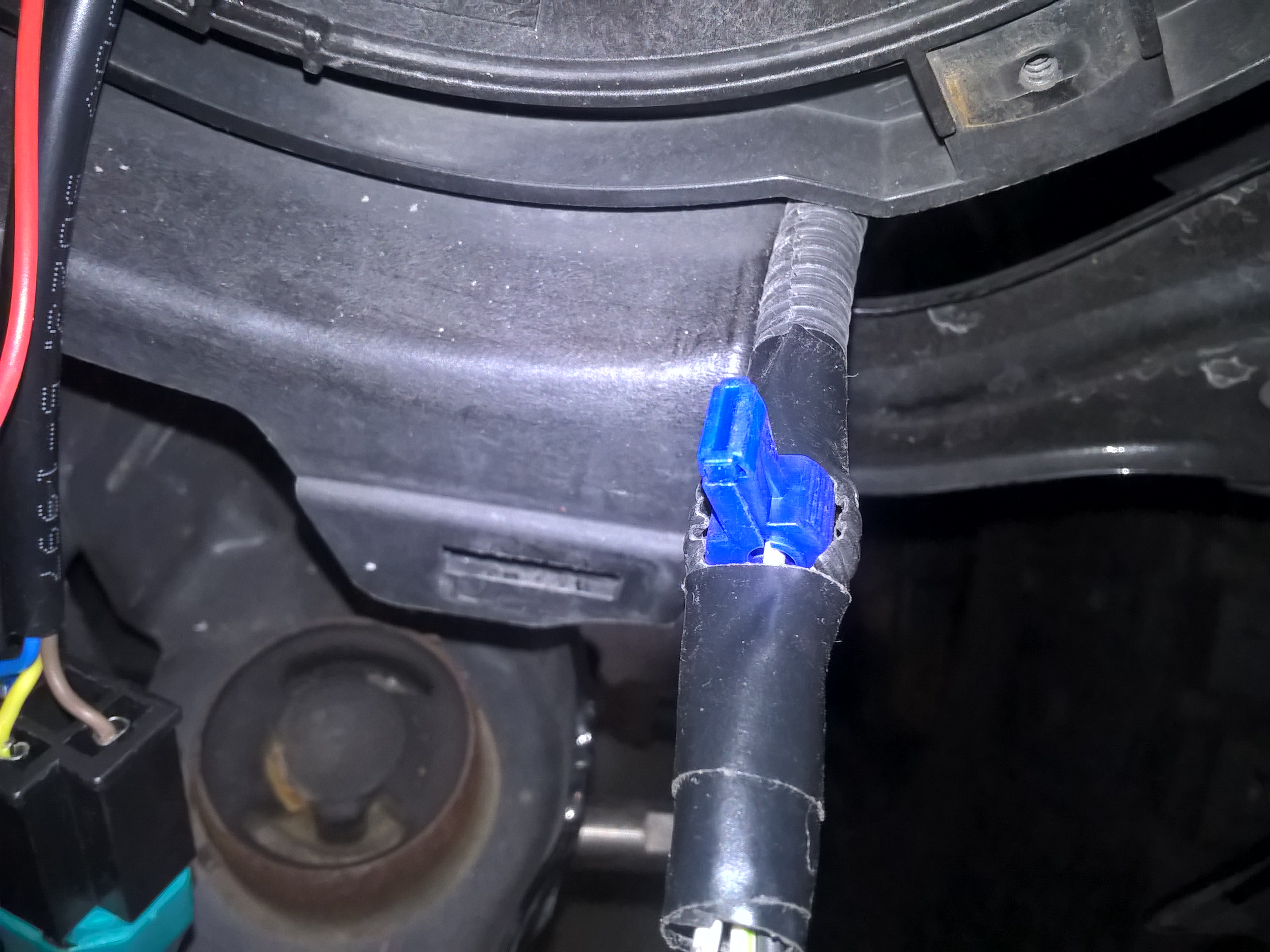

6. Wire up the Yellow DRL wire to blinker
This was pretty straight forward. Instructions were clear, on which wire to tap in to, as long as you stick to the outer WHITE wire. My Driver side was WHITE/GREY and the passenger side was WHITE/RED. Just DONT use the middle WHITE and you should be fine.
Using the blue crimp tap the wire up a few inches. I opted to pull the loom back and then tape the loom in place once completed:
ID:	633487 Click image for larger version

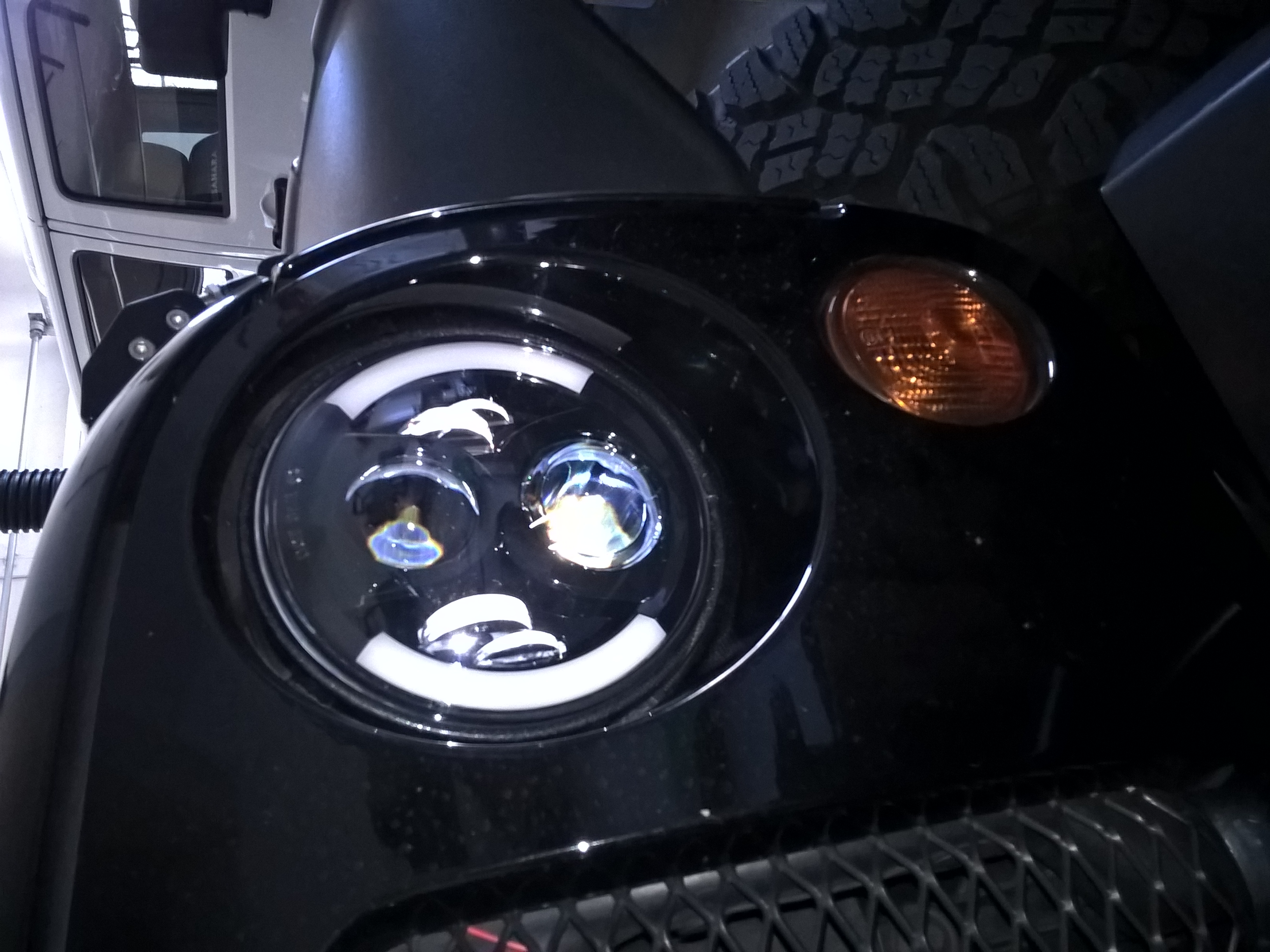

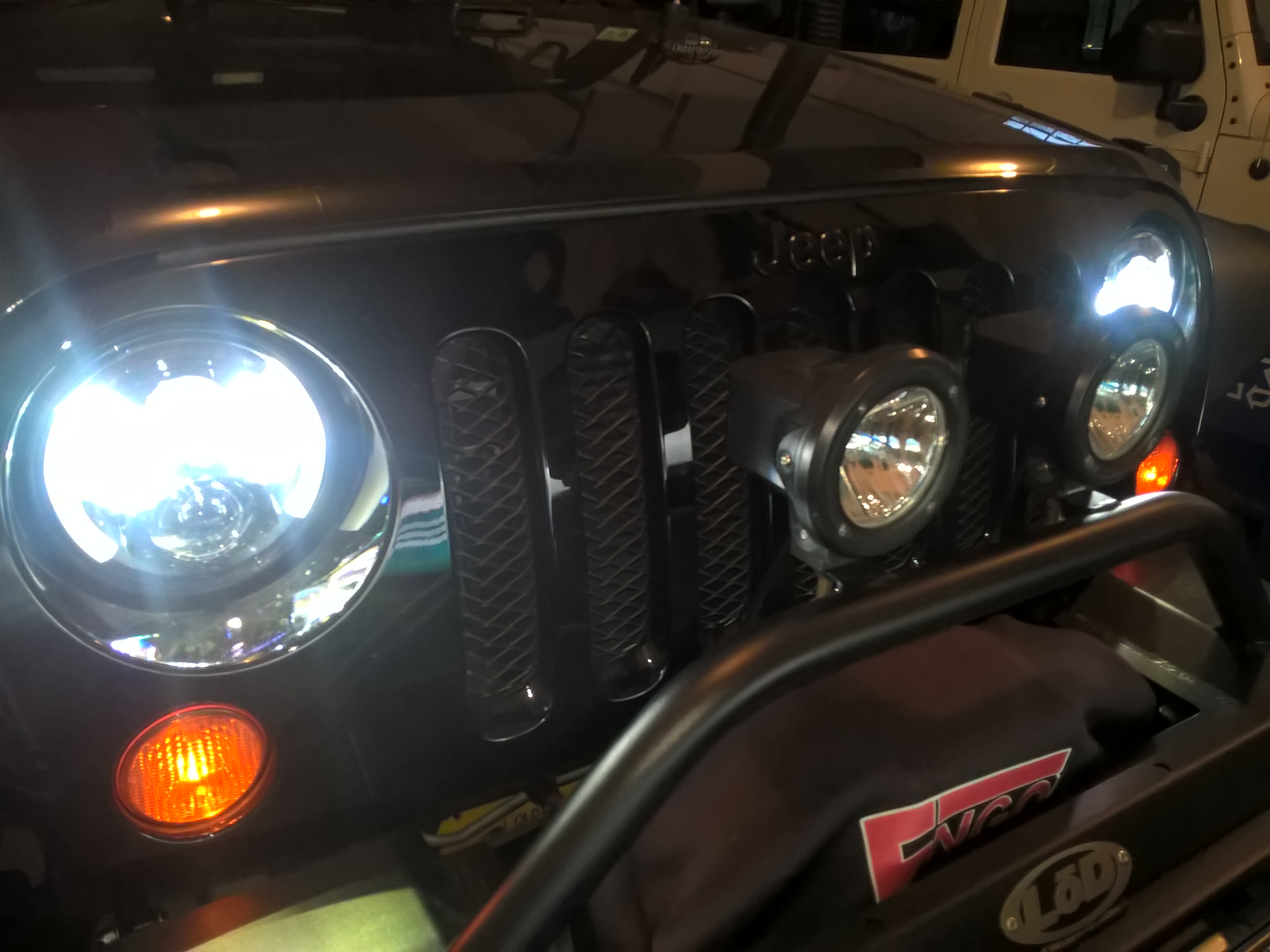

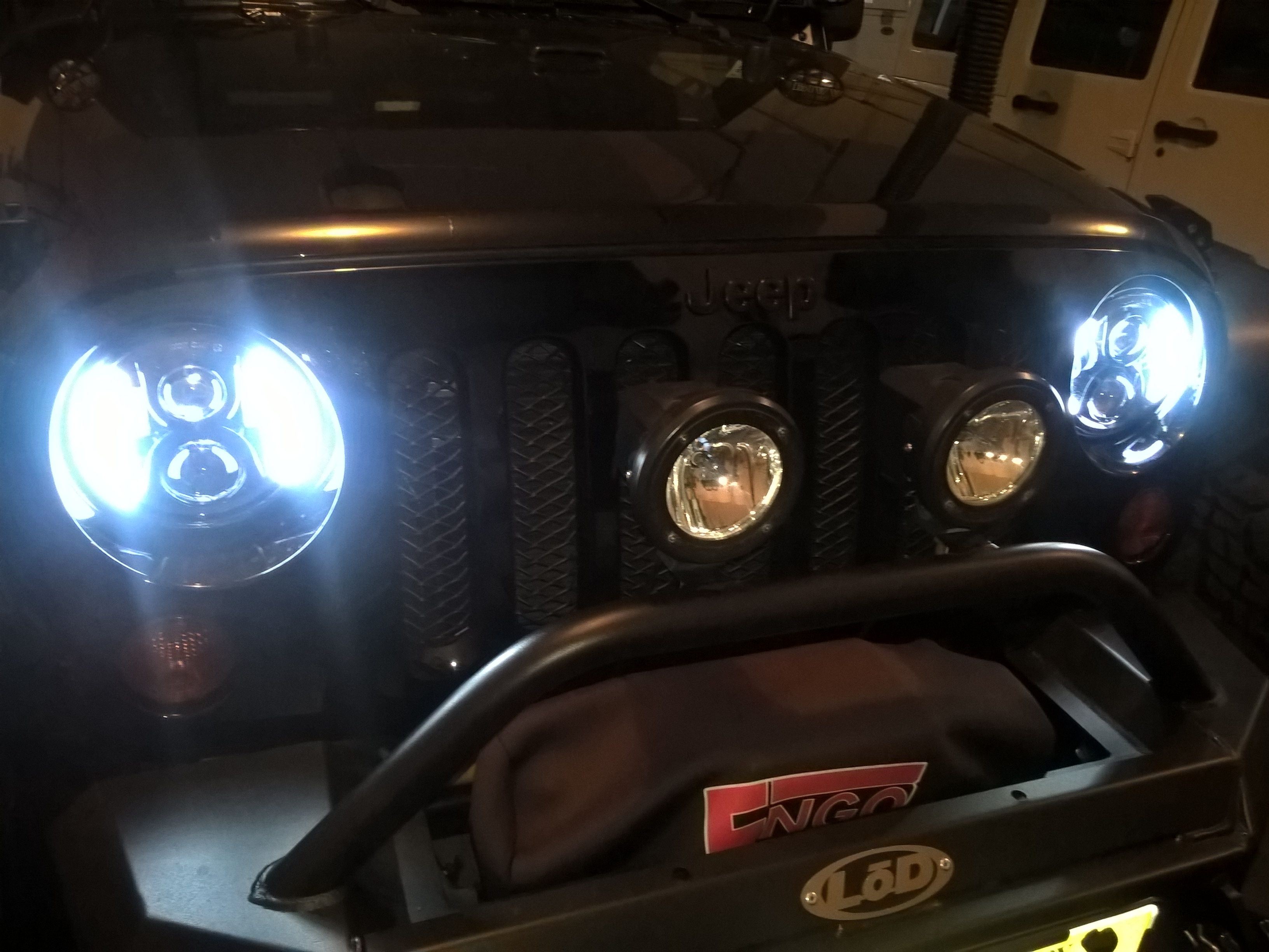

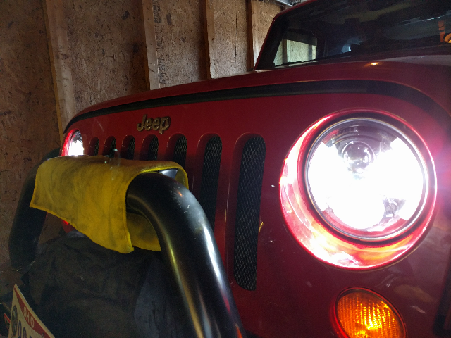

7. Install Lights, Test, and Replace Grill:
I cleaned up the wiring with some loom I had laying around and mounted with my newly painted Headlight brackets:
ID:	633494 Click image for larger version
ID:	633495 Click image for larger version
ID:	633496 Click image for larger version
ID:	633464 Click image for larger version
ID:	633504 Click image for larger version
ID:	633497 Click image for larger version
I only ran them once yesterday at dusk, so I need to follow-up with overall impression after I have had them a few weeks. I cannot compare to any other headlights, as these will be my first LED set.

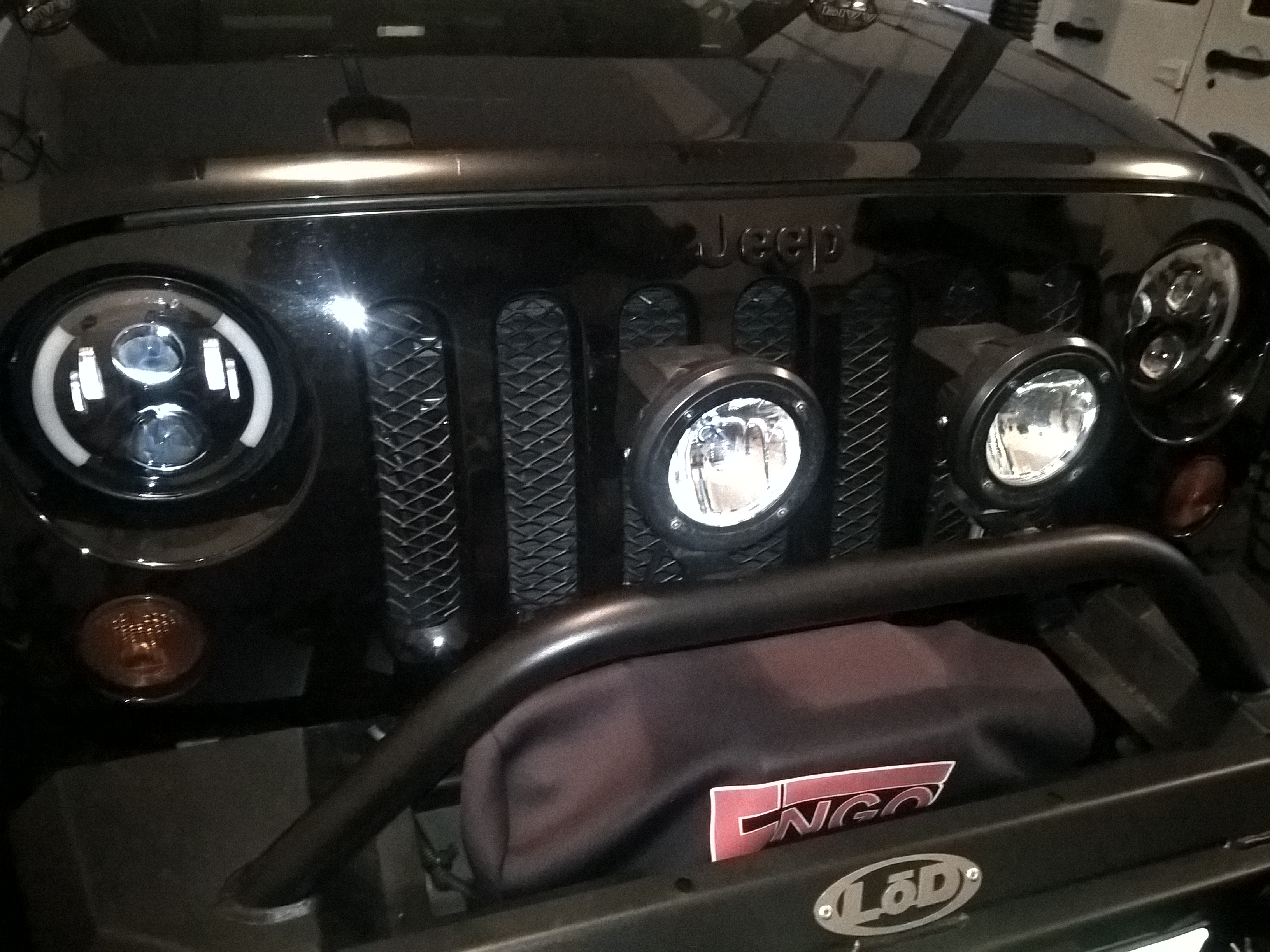

Hi guys. I installed mine on Friday with big thanks to Dustin. I am not great at wiring and I got confused on the turning signal light part. When you receive these lights you will immediately notice the build quality. The entire basket rear of the lense looks and feels great. No crappy plastic materials to break or get warped in time. The front lense looks and feels like glass. The plug in cables fit nicely and the tuck behind the light. Put the rings on and it's done. As I said I only had trouble connecting at the turn signal lights. The wire you have to connect to is heavier then the supplied wire and I had trouble with the snap connectors. So I wound up soldering those two connections. Last night I got a chance to take some pictures using my phone. I hope these help. Lastly...the running lights and turn signals look great. I am super happy ...Thanks Dustin.
Pics 1-3. Daylight pictures [URL=http://s51.photobucket.com/user/onemat/media/IMAG0458_zpsiejgkpwr.jpg.html][/URL
Pics 4-5. First two low and high beams on a dark road.
Pics 6-7 Another dark road low beam and high beam shot.
Pics 8-9 Side view shots low then high. Trying to show distance ...
Pics 10-12 Down at the gas station...
