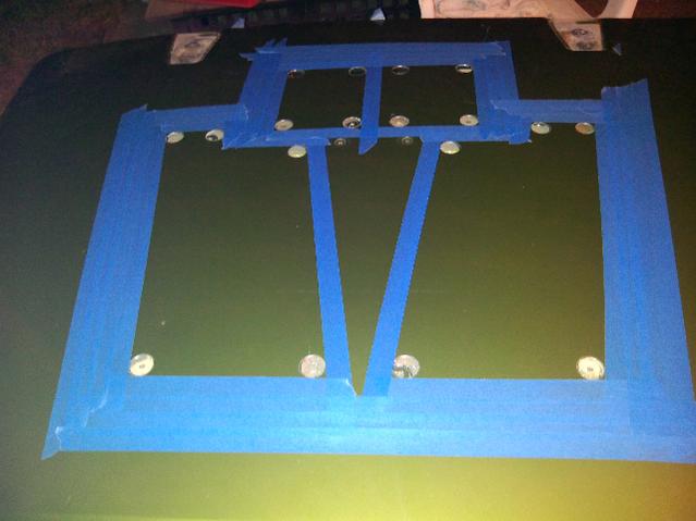

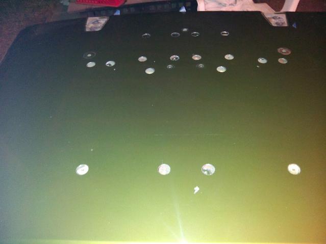

The big thing X is the old one. It will work, just a more elaborate cut.
Use a 4 inch grinder with a thin metal cutting disc, a dremel will run through too many discs.
Take your time, and don't cut too deep.

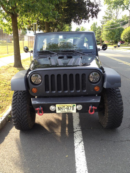

Yea buddy

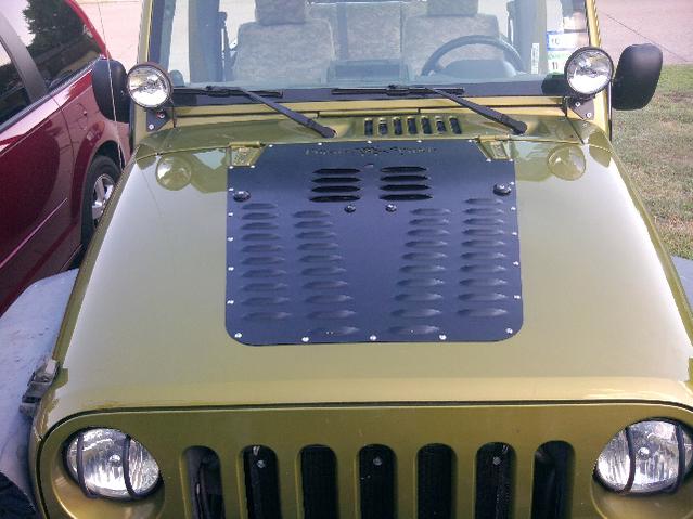

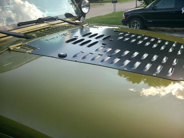

Here it is with the UFOs
The bolts on the big ones could stand to be longer, but I am using the gaskets
ID:	340009   Click image for larger version
