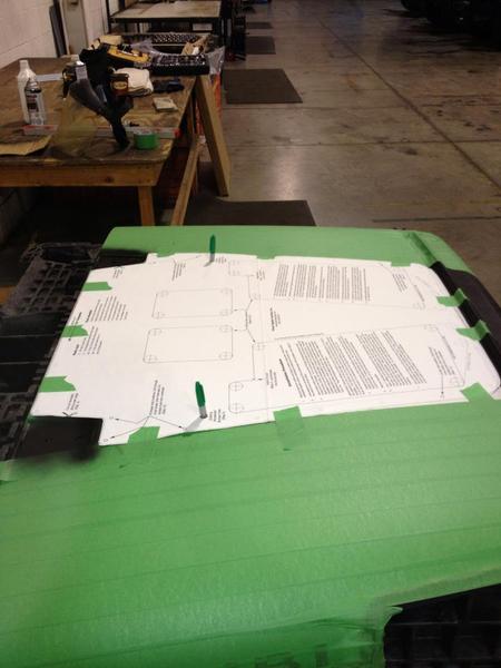

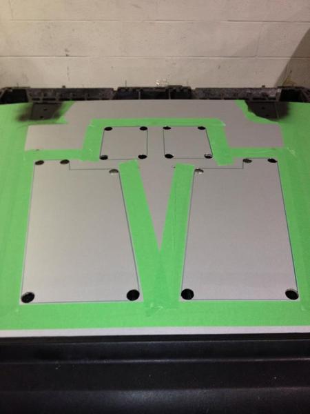

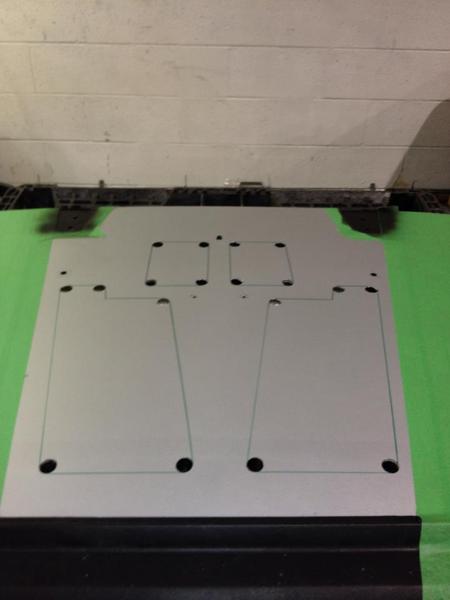

I had a slight interference with my Bushwacker Hood Protector in place but was able to slip the leading edge of the louver panel just underneath the lip...i would have just taken the hood protector off but it is covering a huge dent so i will leave it!

Not really hard but more nerve racking and time consuming than anything. Took me about 5 hours total due to being anal and really painting both sides of the hood completely where the louver would be.
