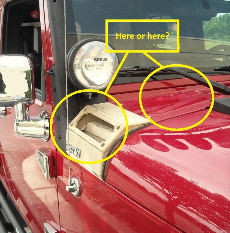

Correct regarding the rearward facing intake..... still playing with locations. .. Here is another image... Still in the early development of the intake so please excuse the amateur look of the design. Easier to work in a solid media to figure out fitment issues before spending time rendering in SolidWorks. The more I do up front the quicker it can go on that side of the development. If we have a hard model that we know does not have fitment issues we spend less time and $$ on rapid prototype media. That stuff aint cheap.
The yellow circles show the two areas I'm talking about.
I think either of these locations will work. i like the side location near the antennae better than the other one. since we don;t need a snorkel for the deep water over the hood 99% of the time , can we get interchangeable pieces to accomplish a couple of things. a hood scoop attachement that would function as a forced air system for everyday driving/wheeling. this would be a nicer day to day look also. then have an extension piece for the offroad days when deep water is expected. both attachments need to be structurally sound when attached. it should be the jeep owners option which piece is attached (scoop or extension tube) and not be worried about it falling off for any reason. should be easy to interchange also between the two options with minimal tubes.
I know you said it is an early prototype of the side cowl location, but is the pic attached an example of what the lower snorkel could look like or is that a pic of the inlet and their will be some kind of snorkel scoop attached?
RR, the left circle area can be very crowded on many modd'ed JKs (with wiring, single or dual batteries underneath, various manufacturer's windshield brackets and various sized lights, cargo / lightbar frames etc).
I do like your idea and expect to be a purchaser (provided it fits with my set-up). I would think the right hand circle area would be the preferred mounting point for a mushroom or ram-air snorkel air intake (same as the TJ's mushroom in prior photo).
There are numerous other accessories I'd like on my JK, but do not have because my current set-up doesn't allow them to fit. Because every JK has a different array of accessories in this crowded cowl area, I figure the right side would win you more orders.
