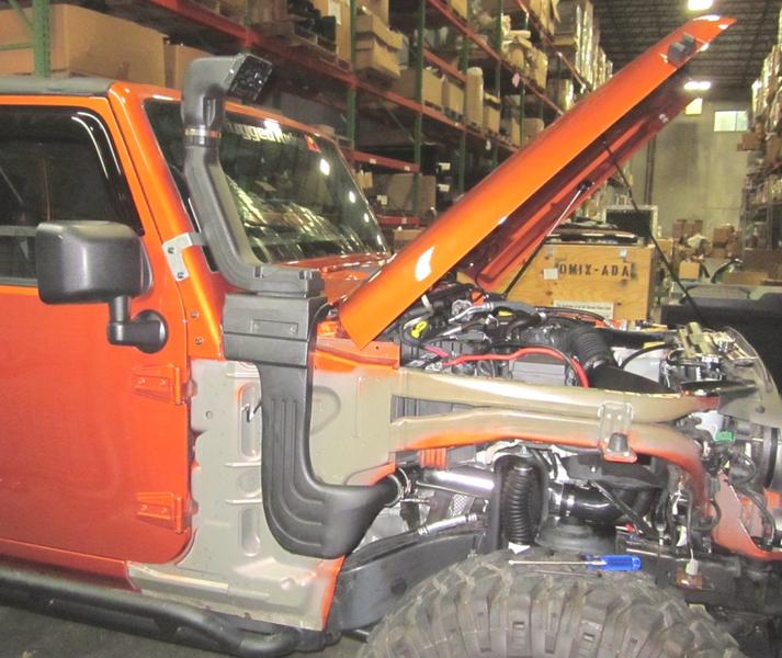

Originally Posted by matzjeep
I have a question for RR, if you were to draw a line across the bottom of the lower hinge. Does any part of this hang lower than that? Reason I ask is I have the Pure Jeep rocker armor and there are 2 bolts that run through the fender just below the bottom hinge line.
Thanks.
This might help.
Name:	SEMA 2011 5.jpg
