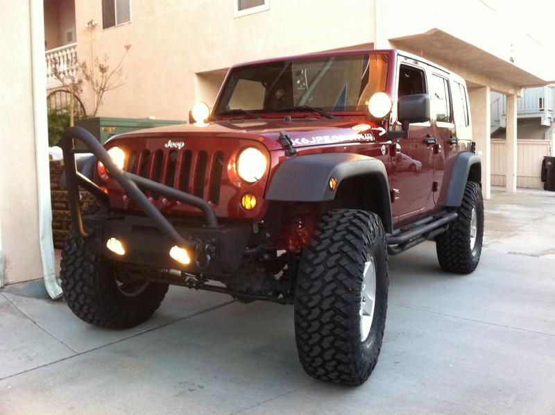

I forget if this was asked, but can I use the hood level light brackets AND the 11232.21 over-windshield light bar with the high mount snorkel?
I've got the 11232.21 light bar but it's not on the Jeep yet (having trouble with alignment, sent an email to you guys already for help)
Attachment 275820
PM sent regarding the light bar....
Yes the snorkel has been design to work with our light bar and W/S mounted lights if you choose the low mount option. At this time the high mount design would require the passenger side W/S frame light mount to be removed. This is the one area that we just could not get around.. literally
Some suggestions have been floated on how to keep the lights but I have not found a design that I think looks good, does not cause the drivers side to look funny sticking out and does not vibrate.
