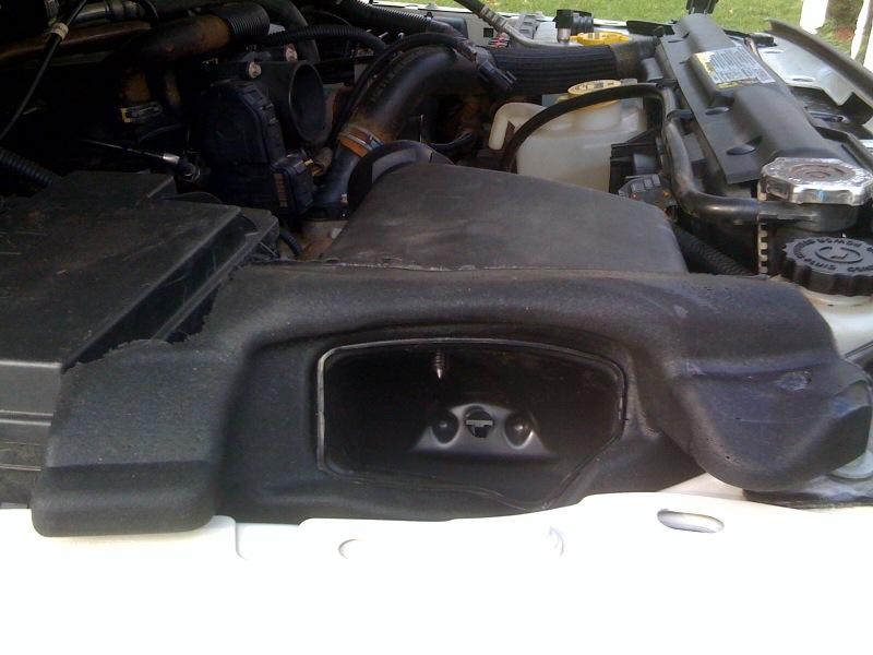

Mopar inlet seal - the only way for water to get in is to bury the hood underwater - and if your in that deep your probably flowing down the river anyway!
Name:	inlet seal..jpg

Attachment 84921
Is that what you run now? i see on the thread about mopar inlet seal you mention hydrolocking your motor has the inlet seal worked since then, and can you get one in the US? from reading that thread, i thought that was an export only option.

yes, the inlet seal is on my rig now. had to have a friend in Germany order and then bring over when they came to visit. stupid that mopar/Chrysler does not allow you to purchase where manufactured - USA. decisions like that are why they are bankrupt.
never heard of hydrolocking with it? sounds like BS since the inlet seal seals your airbox to the hood/fender, and the only way air or water can get in is a small slit in between the hood and fender. you'd then have to fill your airbox up with enough water to be sucked up through filter with enough volume to cause compression issues.
Attachment 84921
Do you have a part number for this? Would like to get friend overseas to send to me. Thanks.

Default MOPAR jeep wrangler inlet seal part number 53034131AB
