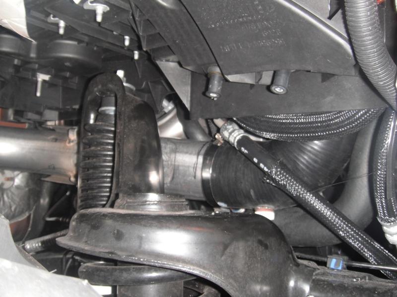

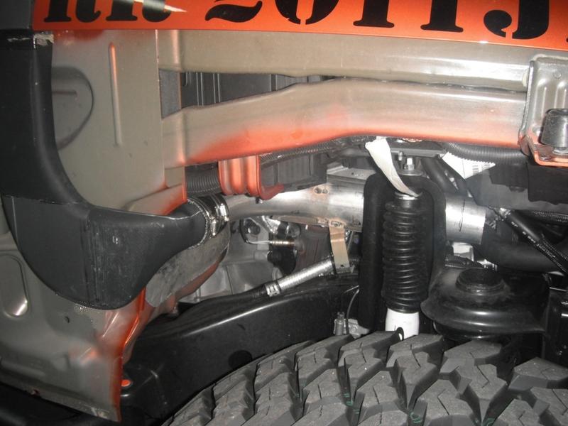

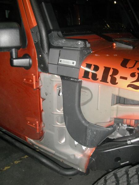

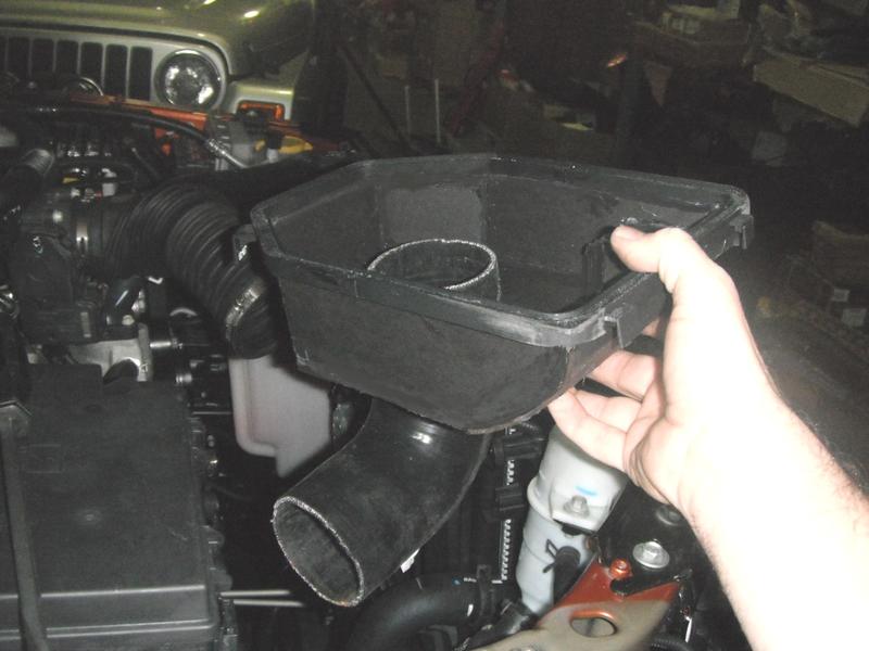

OK... working with my mold vendor and we are having to rework a few parts to allow them to be removed from the molds with less effort (very important for large scale production). These are the small things you just cannot take account for until you are this close to production.
Here are a few images of the early prototype installed onto our 2011 JK (so please excuse the quality of the image and the rapid prototype part). As you can see the main body of the intake is mounted inside the front fender. This requires the removal of the front fender, but the flare can come off with the fender (at the same time). The side cowl will need to be removed (spot welds drilled out) and a section of the front fender will need to be removed. From there it is rather simple. The lower section of the air box is replaced and an aluminum air tube is routed between the engine and the shock tower. The stock air filter and intake tube to the engine are retained.

Hmmm.... I like the concept....I am a little concerned with that much of the snorkel assembly sitting fairly low. A lot of water crossings are at about that level so if there was small crack or the seal wasnt perfect you would have water coming in.
if it was routed higher than you would be narrowing your chances of having water come in.
Just thinking out loud here. I am by no means an engineer

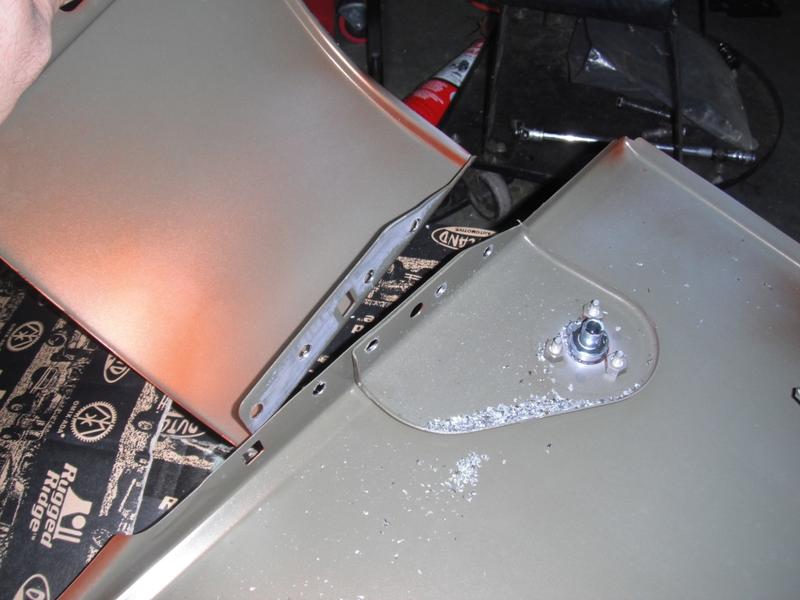

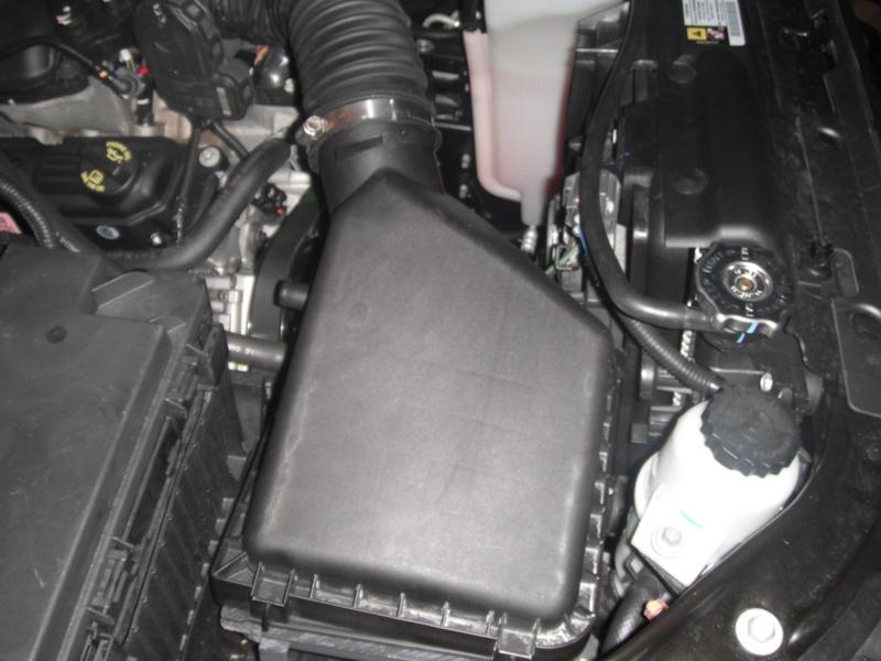

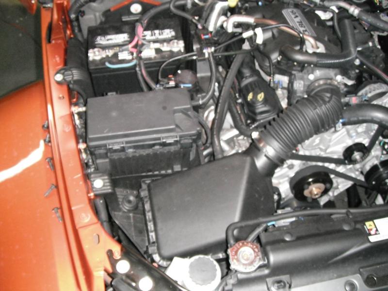

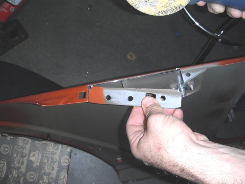

Here are the other images showing the air box mounted and what part of the fender you will need to cut.

Old Aug 26, 2011 | 05:48 AM

Originally Posted by Rugged_Ridge
As you can see the main body of the intake is mounted inside the front fender. This requires the removal of the front fender, but the flare can come off with the fender (at the same time). The side cowl will need to be removed (spot welds drilled out) and a section of the front fender will need to be removed. From there it is rather simple. The lower section of the air box is replaced and an aluminum air tube is routed between the engine and the shock tower. .
After seeing what has to be done to install this one, I just crossed it off my list. WTF!!
Nope... your question is a good one and we spent a good amount of time making sure this is not an issue. The deep section of the fender intake has been designed to trap water if taken in from the intake. This will be able to be drained if needed. The intake from this body is raised and runs at a slope up to the air box... this will also allow drain back if needed. Keep in mind that you should never be in the water that deep for very long (In and out) otherwise you are going to have a LOT of issues. Sorry to say that we cannot fix stupid... . By that I mean we can only account for issue that happens when your vehicle is used incorrectly.
All connection points will have high quality straps and high temp silicone elbows. We will also instruct where to add sealant during the installation.
