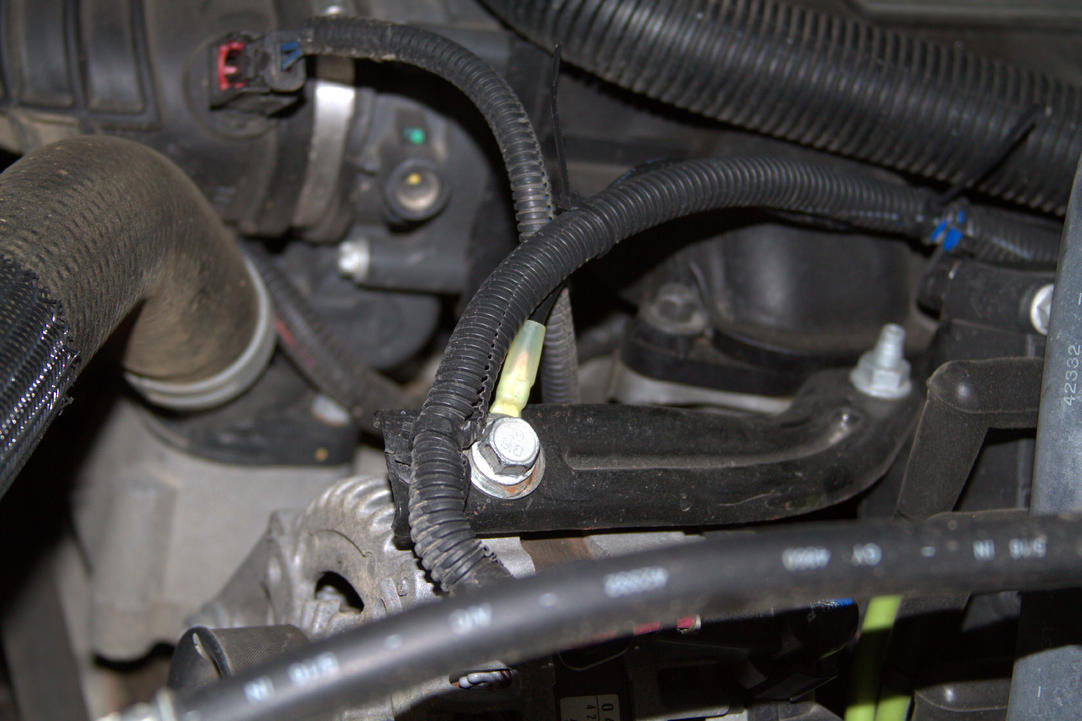

Originally Posted by toad
Interesting. Got any pics?
I made a small album that is in "My Profile" for the JK No Cran[IMG]Click image for larger version
Name:	cable root..jpg
ID:	71445Click image for larger version
ID:	71446Click image for larger version
Name:	wire and ring terminals..jpg
ID:	71447Click image for larger version

So it's just a bad grounding issue?!

I just got back in town. I added the wire from the negative terminal to the alternator bracket this morning. I was at Auto Zone getting the stuff to add the wire and the Jeep wouldn't crank when I was trying to leave. I put it in neutral and it started right up. So hopefully this will stop the "No Crank" issue. The no crank thing happens like every other day, so I'll write an update in a week or so.

It's been three days since I put that extra ground wire on, so far it's been starting every time. I did notice when I was doing it that one of the fender mounting bolts , under the hood, on the passenger side was covered in corrosion. The same type you get on battery terminals.
