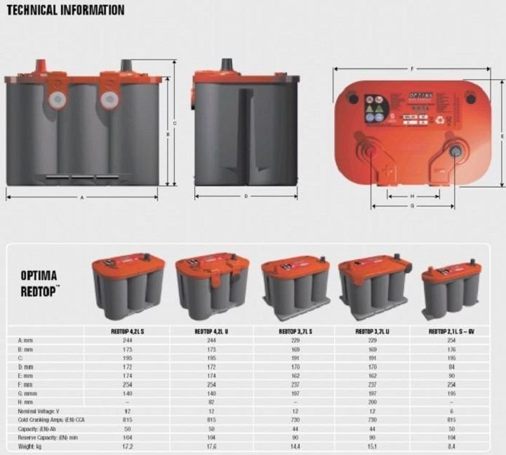

Cold Cranking Amps (CCA)
The CCA is predominantly listed on each battery. It is crucial that you get a battery with enough CCA for the environment in which you live. Wrangler owners in warmer climates, such as Texas or southern Florida, can get by with lower CCA values than those in Main or Canada. You don't want to be left stranded in the dead of winter with a new battery that has too low CCAs to get your Jeep running. Batteries with very high CCAs are often referred to as deep cycle batteries, and you may have troubles finding such batteries that are the correct size for your Jeep. The CCA rating of a battery should be the most important aspect in choosing the battery for your Wrangler.
Figure 1. Capacity definitions of any given battery.
