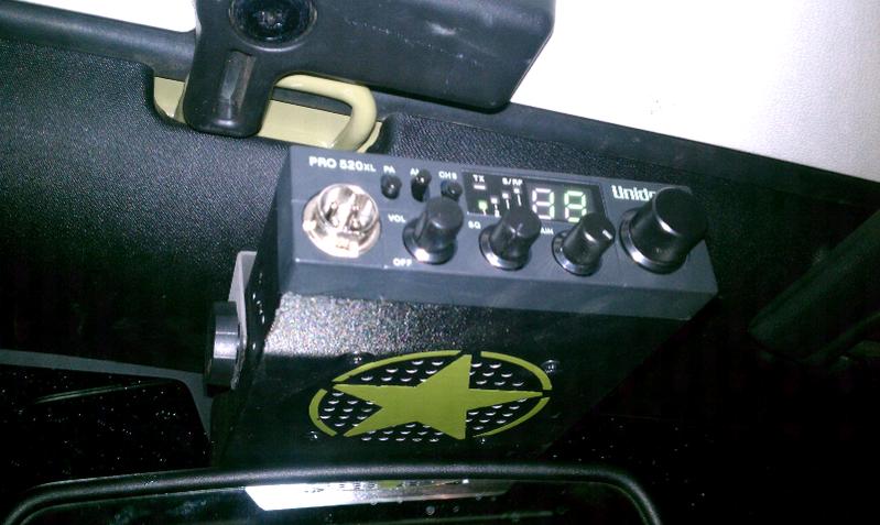

Stole Verv's idea and I'm very happy. It's a nice solid location and allows for some good sound from my 520.

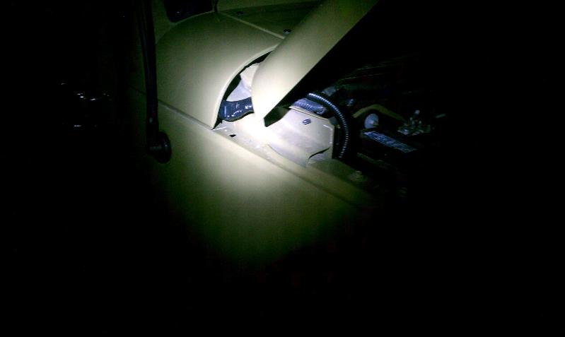

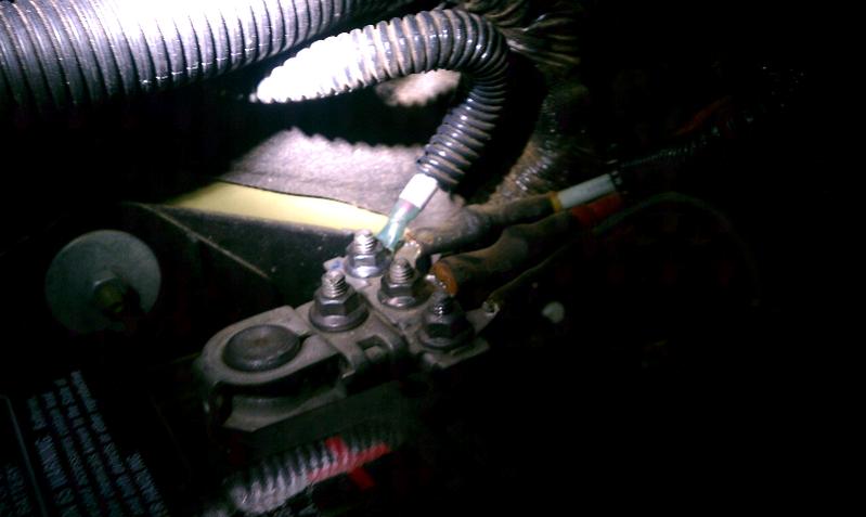

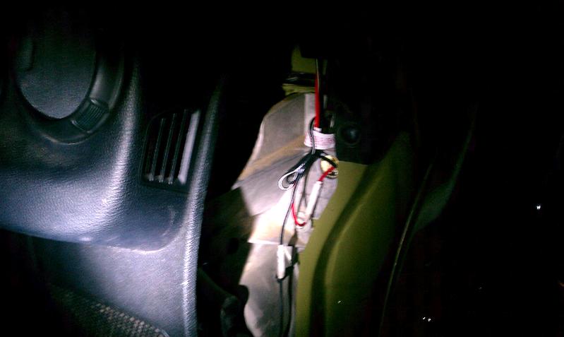

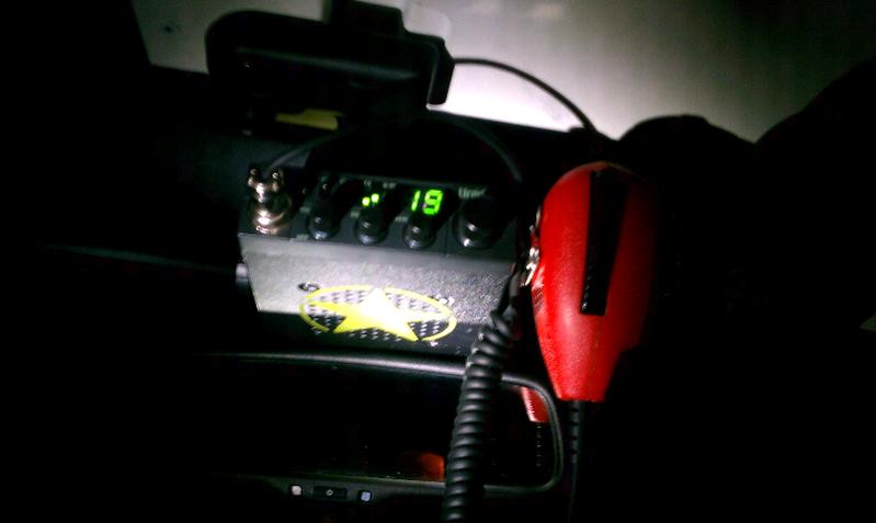

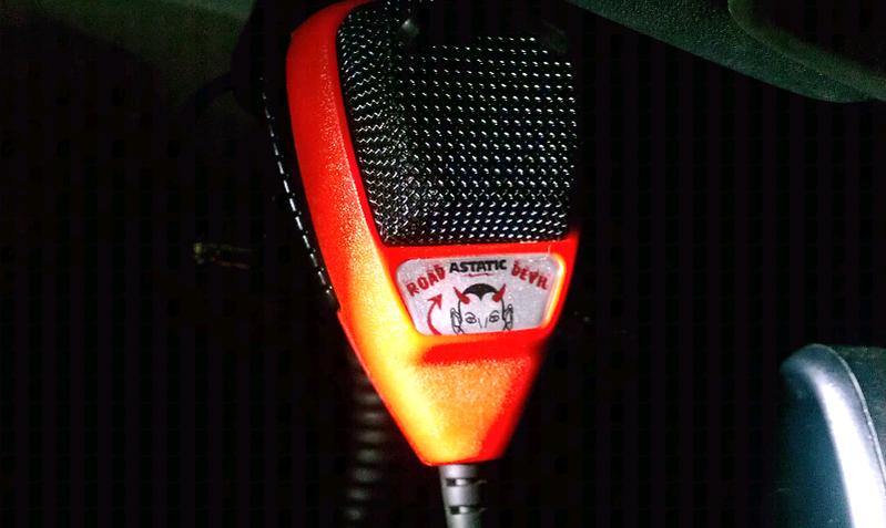

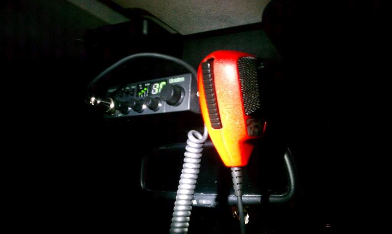

I just wired mine directly to the battery and ran the wire thru the passenger mouse hole. You can pull the vertical pillar back enough by hand to tuck in your wire. Then the whole center section above the mirror snaps in and out of place.
I didn't pay attention to the depth of the radio in relation to the windshield so I.would recommend going a bit nor forward as the other guy did. I drilled my holes center of the vertical curve but you should move that forward an inch or so. The center section over the mirror has plenty of room to tuck your wires in.
I copied the location and its a perfect spot. I also happened to go with the Uniden pro 520XL then upgraded my mic to an Astatic power noise canceling designed by Road Devil.

X2. Just tuck the power wires in the trim by hand down to the firewall feed through. I did the same for the coax across the front, then followed the roll bar to the back to my antenna. My antenna is mounted to my tire carrier.

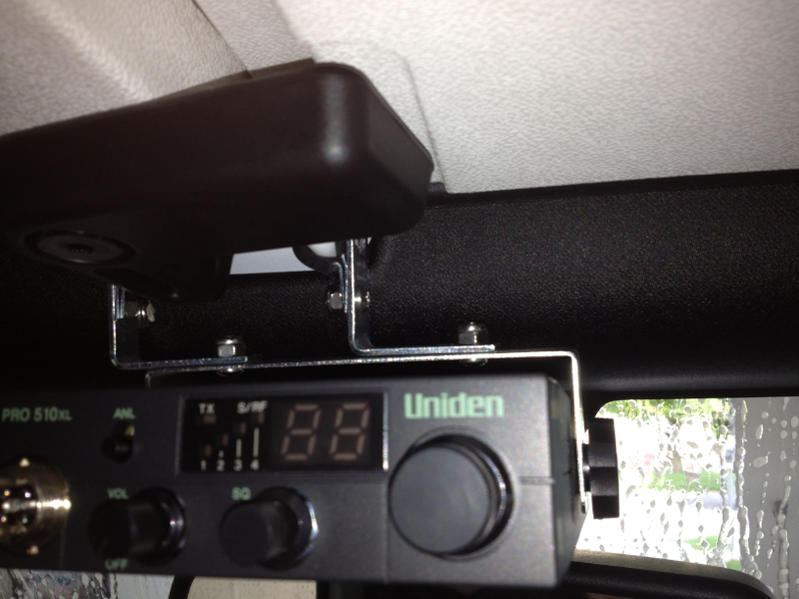

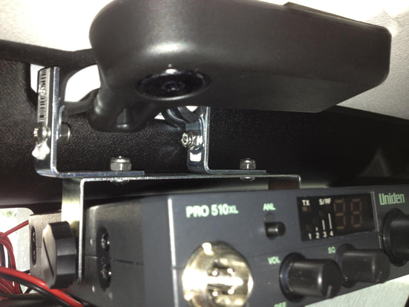

I installed mine today. I got the idea from here. (I've seen so many though I can't remember who to credit. Sorry & THANK YOU!)
It's two 3/8" insulated wire loops, two 1" corner brackets, machine screws with lock nuts. I drive 4 miles a day on a rough dirt road. It's very solid and I'm really happy with it for the few $$$ I spent.
I still have to run wire to the battery and am waiting on my 25' antenna wire to arrive. More pics to follow.

I am going to pull the brackets and hit them with a rattle can of flat black. This was a shot of my test fit.
