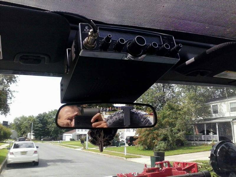

I put mine right above the rear view mirror....just screwed it in, no special mounts....just the supplied cobra mount

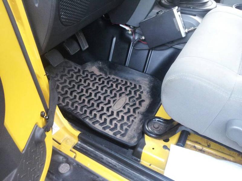

I was thinking about doing that. I like the look. I put mine on the side of the center console. I offset the mounting hole and used a spacer to make it fit. I'm also in the process out bedlining the interior.

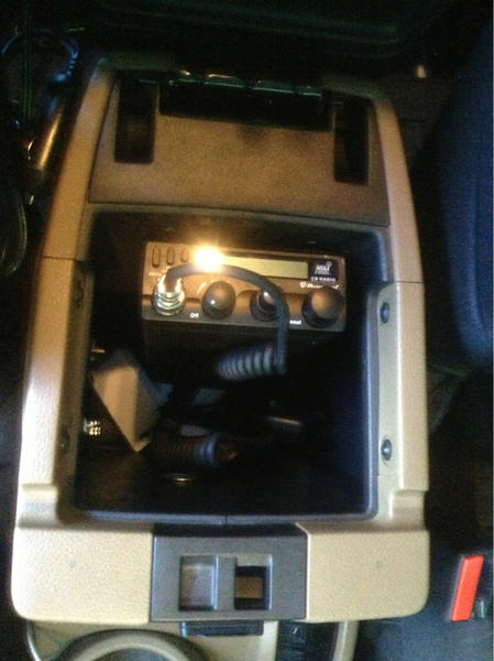

Here's mine tucked away in the console.

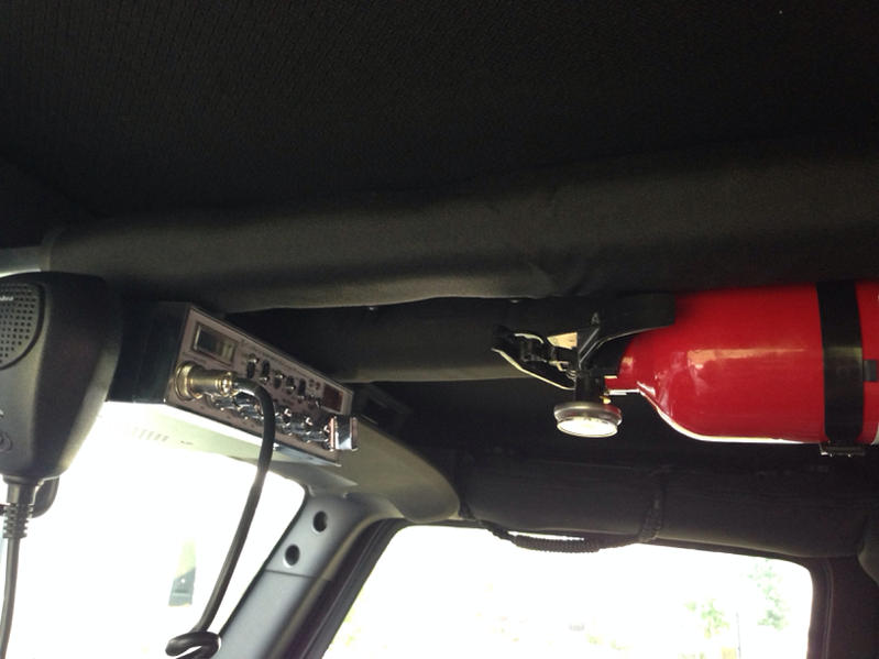

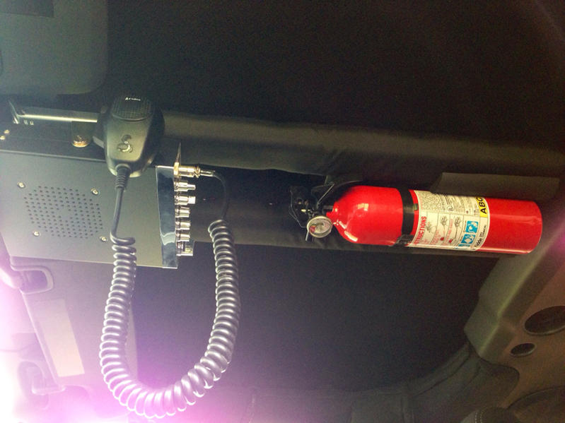

Here's my version of an overhead mount.
