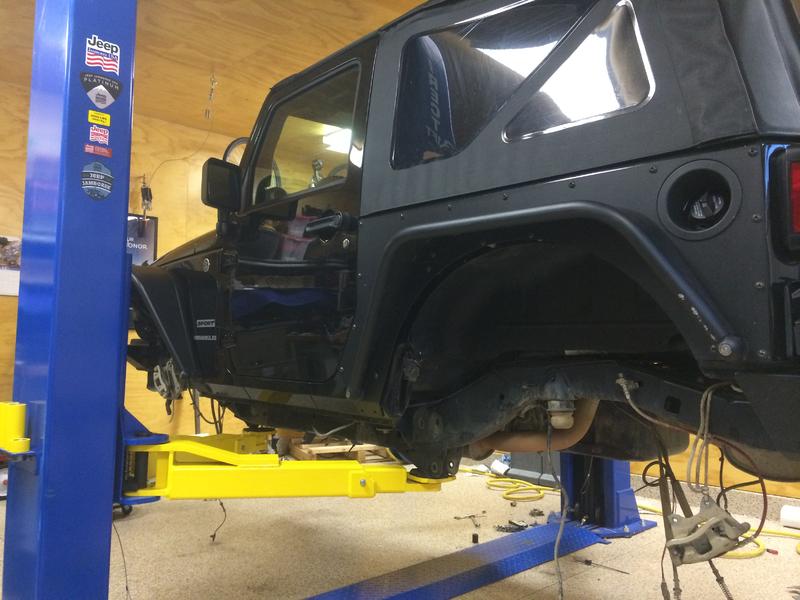

The fun began today. This morning, nice and clean. Dang those 40s make my 37s look small. And this afternoon, all pulled apart (still need to remove the gas tank, bumpers, and exhaust, but I am rolling solo in the garage and got a bit tired).

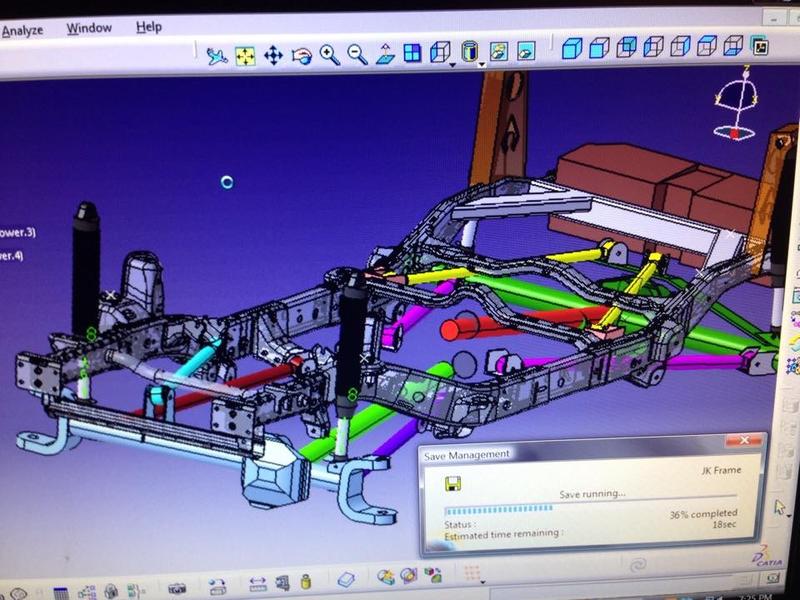

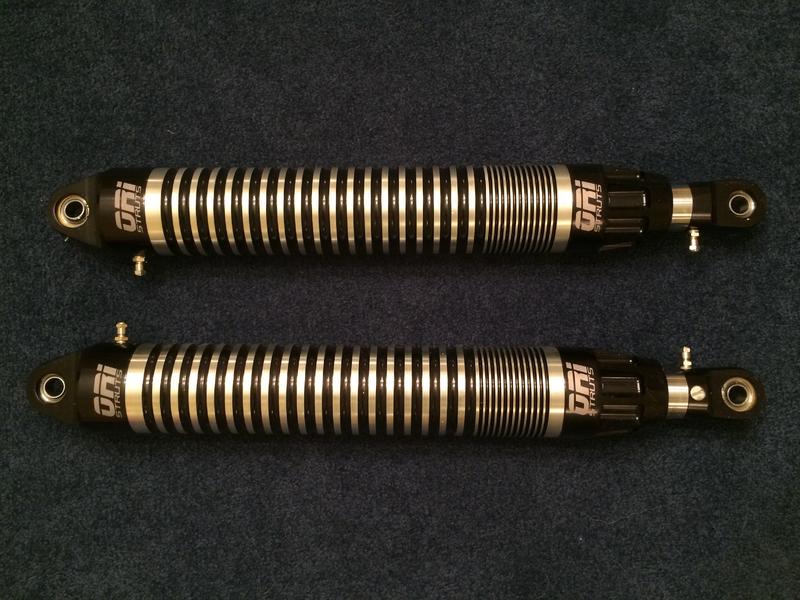

Probably a good time to provide some teaser to the build. Partial mod list:
- Axles: D60 and Sterling 10.5 off of a 2010 Ford F350 (72" WMS to WMS)
- Suspension setup: Double triangulated four link rear, 3 link front
- Stretch: 7" rear, 5" front (still hydro assist; wait for the magic)
- Articulation department: 16" ORI STX struts all around
- Gas tank: relocated to a sneaky place so that I can still use the rear seat and have storage
All fabrication done by me.

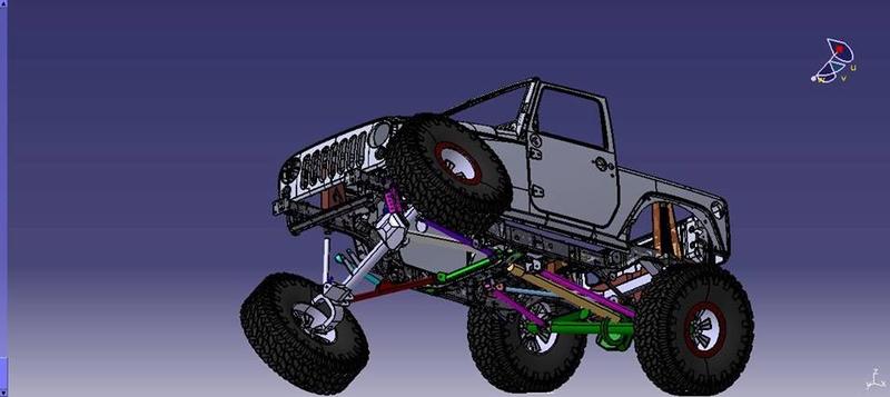

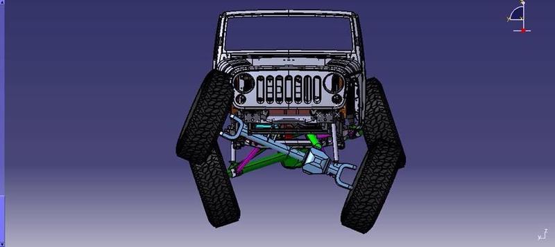

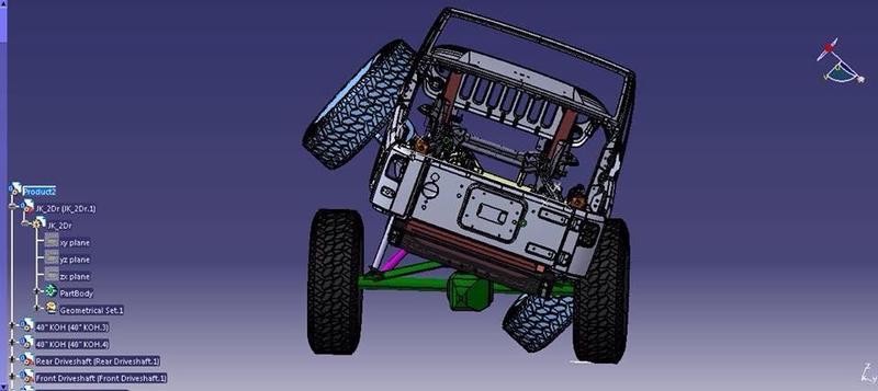

A huge thanks to an engineer/friend/Jeep god, for creating a working CAD model of the build. Talk about saving me some serious time!!! This guys talents are insane. Enjoy the few sneak peeks. And yes, that is a 40" tire 50" off the ground with all others on the ground. Ignore the body, it would be a bad use of time to comp cut a picture.
