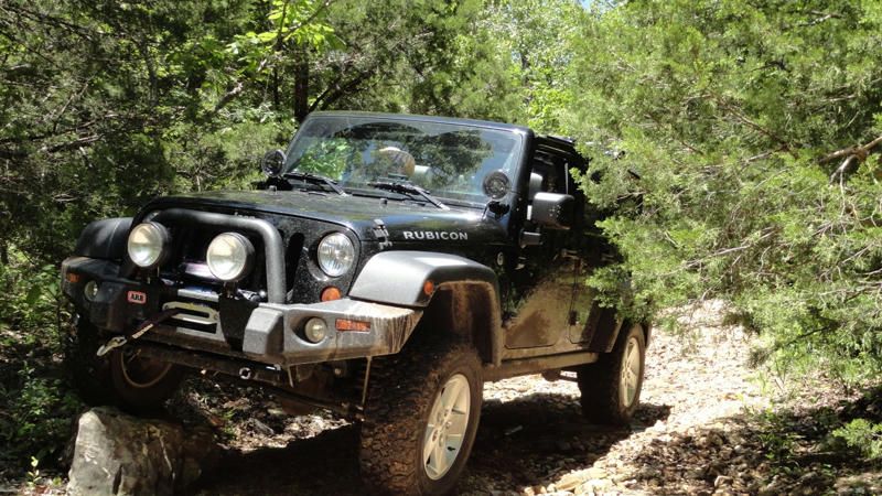

So I've been looking at the new '12s (or reading about them) And I'm thinking I might want to take the leap from my '07 JKU-Rubi... for more comfy seats, engine, 5sp tranny, and I hear a better orange color.
Which of course leads me to thoughts about how I would build it... when suddenly it occoured to me.. even if I don't get a new Jeep.. I might want to rebuild the one I already have.... perhaps I've been building it wrongly... especially since I wouldn't do it that way again.
The mods that matter are a OME HD lift with LT shocks + control arms, and track bars. I also have an ARB deluxe front..
And I like the mods I have now.. I'm just not sure they suit me..
Let me be specific... I like the breakover angle. It rides better than stock imo.. it handles not quite as good as stock.. The bumper is tough as nails, and looks GREAT... I couldn't live without a winch.
I left a factoryish rake... but it still sags beyond level when loaded. the Jeep is never sitting level.. and pulls on the road due to this.. even though my break over level is good, my clearance is unchanged due to factory tires. My wife already has trouble with the height.. and I don't want to make it worse with bigger tires... and the Bumper bugs me because it's pretty heavy...
So here's what I was thinking.. Teraflex leveling kit (the coil version) with OME shocks... + the Airlift airbags w/ auto leveling system... Flat fender flares, and 35 inch tires.. I MIGHT still need front control arms and front track bar...
I was thinking of going with a J8 style front bumper with my same winch on it.. simple.. extremely light weight.
This way I would have higher clearance.. auto leveling.. sag reduction.. should still have a 2 inch lift for break over concerns (due to tire height) and a lower center of gravity...
Thoughts, or opinions?

Originally Posted by RayHoliO
... Thoughts, or opinions?
I'll be interested in your experience. My rear end sags about 1.5" now when in expo configuration (hard top, rack, etc) and about 0.5" when in "summer" configuration (some type of softtop). I have 3" OME HD springs on order hoping to compensate. We'll see.
As for front trackbar and LCAs: Get those and straighten out your tracking and camber. You'll appreciate the better steering feel (LCAs fix that).
