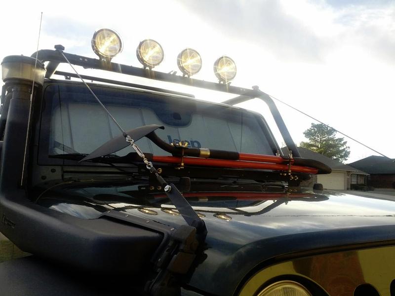

Ditto on Offroad Elements. I have them on mine, but fabricated a short bracket so that I could install them to the MRBP overhead rack extension instead of the supplied brackets mounted into the windshield frame. Contacted Eric at Offroad Elements and asked if they could make a custom length so I could remove my bracket, and he said no problem and will get back with me on price. Superb product--every component is top-notch in quality.
Name:	Limb Risers, Feb 13.jpg
