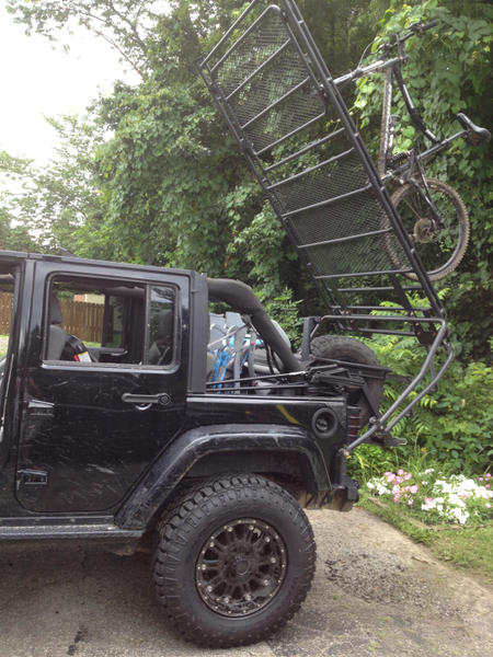

As far as tilting back while loaded, light stuff like a bike = ok. 200lbs of luggage would not be advisable.
