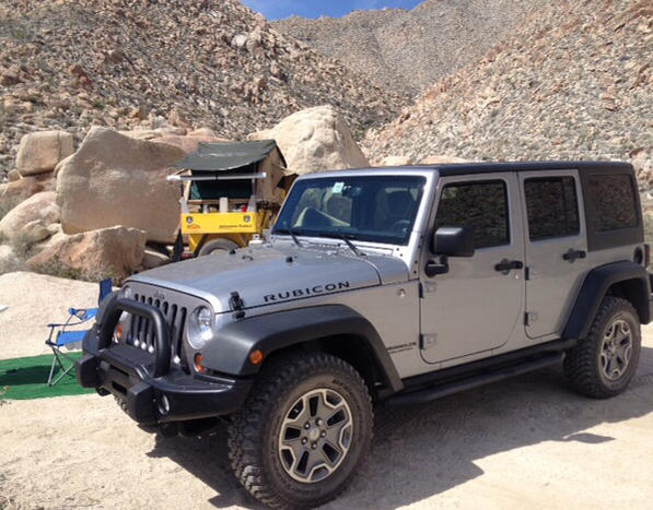

I installed the 7-pin harness about a month ago. It is pretty simple as long as you are reasonably handy. Make sure you focus on preserving as much length as you can as you work forward. Mine was just barely long enough on my JKUR. The battery orientation changed with the 3.6 and I don't think they updated the harness, so it gets a little tight at the end. I focused on keeping mine away from any moving parts or exhaust as much as possible, so that may have contributed to my issues with the harness length. It fit on the first try but I was getting worried it wasn't going to reach the terminals as I was getting it finished.
For the brake controller, I ended up going with the Tekonsha Prodigy wireless unit and it works very well. This controller is installed on the trailer rather than in the Jeep. I can tell you that it would be simple to install a controller in the cabin of the Jeep. Chrysler makes it very easy with a handy grommet though the firewall in just the right place. The hardest part is finding the right 12V power lead to tap. I did some research on various forums and found out what the right wire was - found it under the dash and would have been a breeze, but in the end went with the wireless unit. If you have any trouble figuring it out let me know. I think it was the tan wire coming off the brake switch under the dash.
The only issue I had with the Prodigy wireless controller was when using a pintle hitch on my Adventure Trailer Horizon on washboard roads. The pintle allows some front to back motion and the brake controller got sort of confused as the trailer was bouncing forward and back. Only happened once and was not a biggie, but for regular work with a pintle I would want the brake controller in the vehicle rather than on the trailer. Here's the trailer and Jeep in Anza Borrego this spring.
