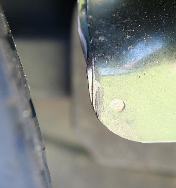

So had I. I had to trim them even more! The problem was that when very heavy and hitting a dip then the wheel rebounds, the tires bulge out. At that point I'd get brief rubbing, even though the pinch seams were already trimmed. So, I trimmed them even more, and that fixed it. It is this very dynamic situation that causes 35s to rub that folks checking their tire clearance while on jack stands/lift overlook.
Pinch seam, after trimming the first time. I had painted it, but still heard rubbing while on White Rim Trail. So would trim it again after this image was shot ...
