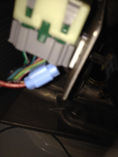

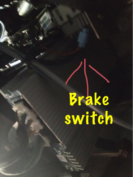

Here is the write up on the MOPAR 7 pin trailer connector I installed today. Put a Tekonsha P3 brake controller too. I just have to switch the connector to the bottom connector on the tail light instead of the top, so the left side lights work, just ran out of time. It really went better than I expected. I put the controller below the turn signal stalk, it's close, but has enough clearance to make it convenient and not in the way too.

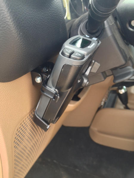

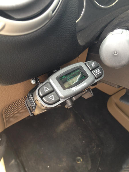

Everything working great! Hooked the Mopar harness to the bottom connector on the tail light and left and right sides work perfect.
Here is the brake controller I put it. A Tekonsha P3. Fits well and is the best on the market with a digital accelerometer instead of a pendulum. Got it installed in a great place where it isn't in the way, I can see it and I can activate the manual brakes if need be.
