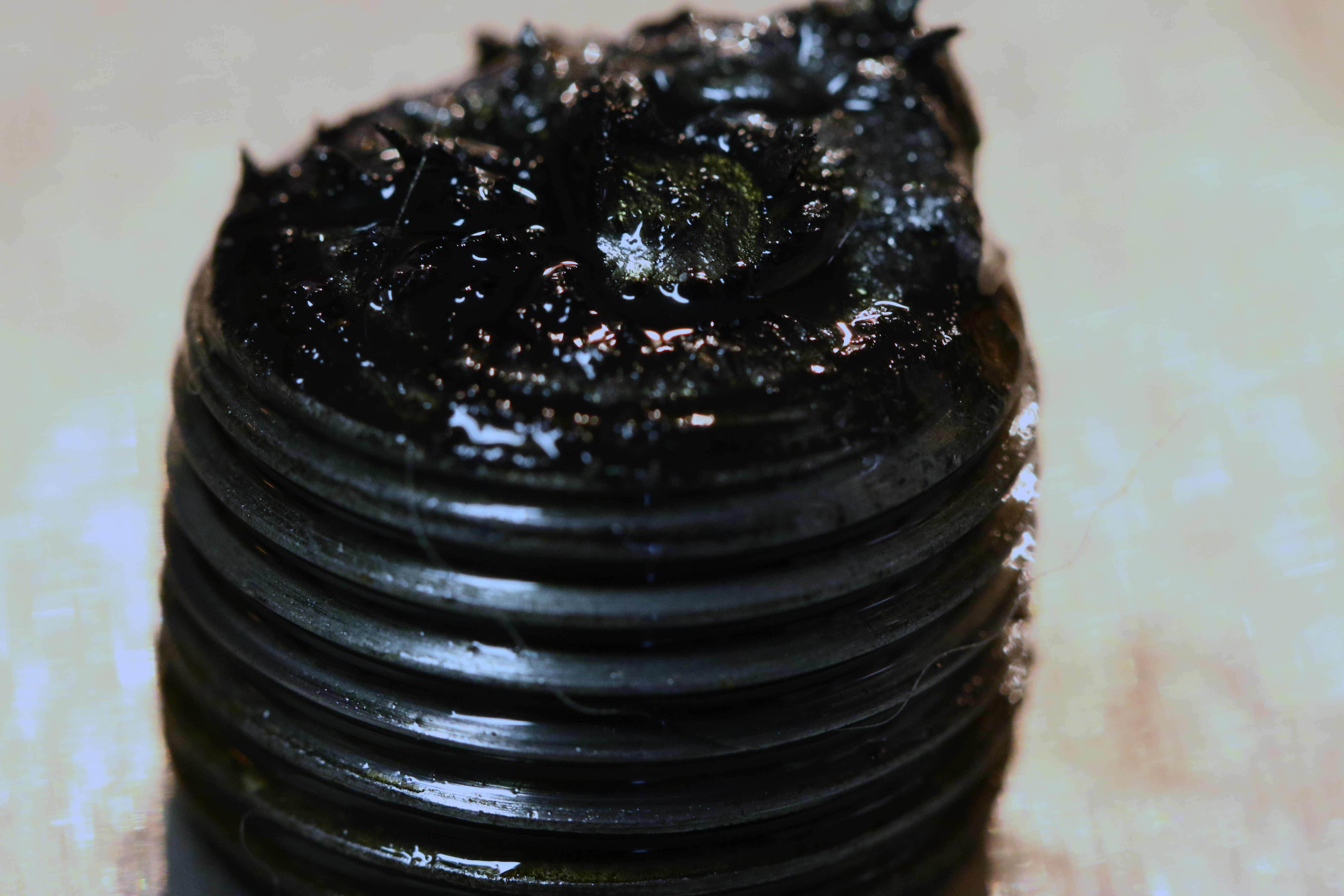

Drain plug. Definitely should not look like this.

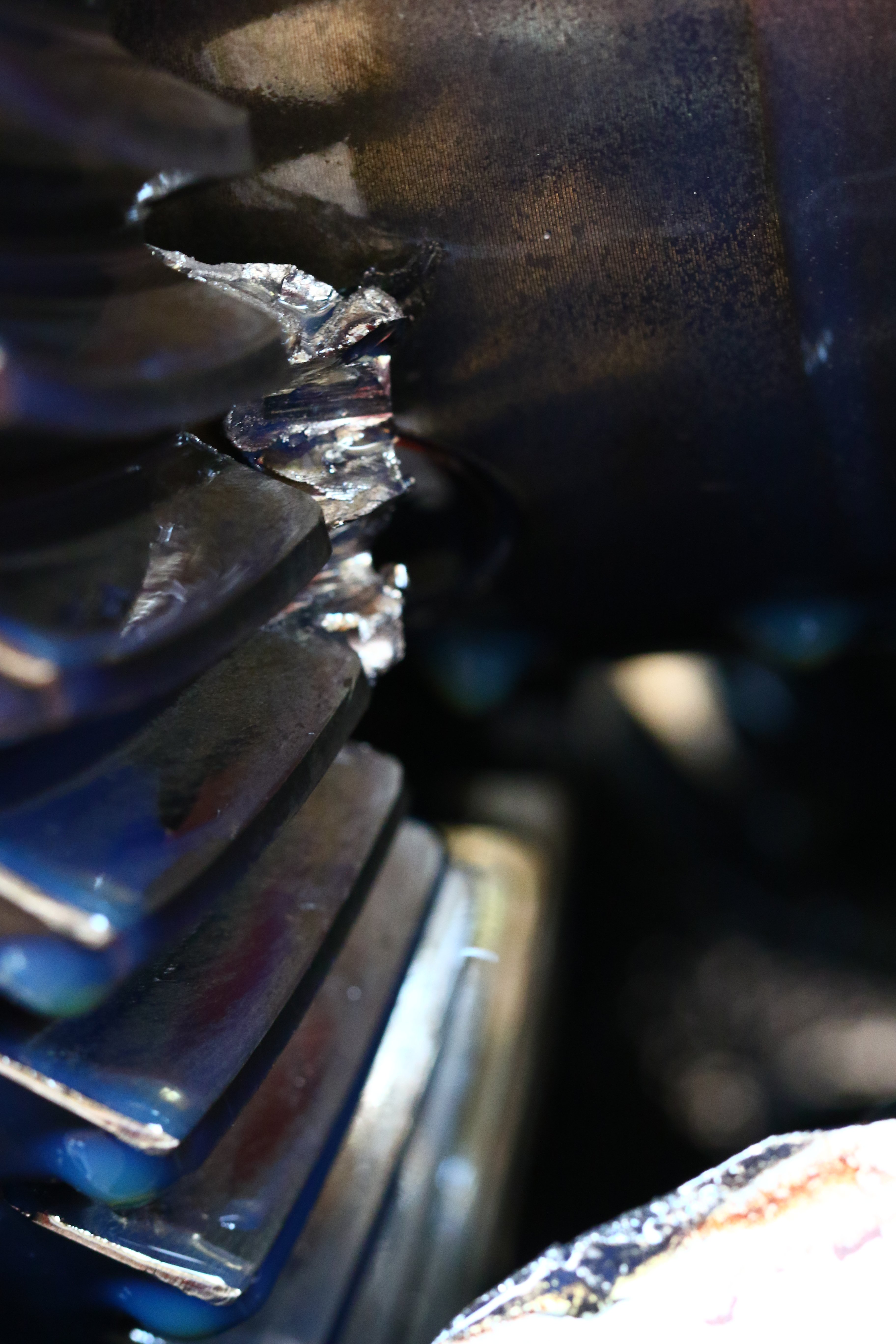

Couple teeth from the pinion gear hung up in the ring gear.

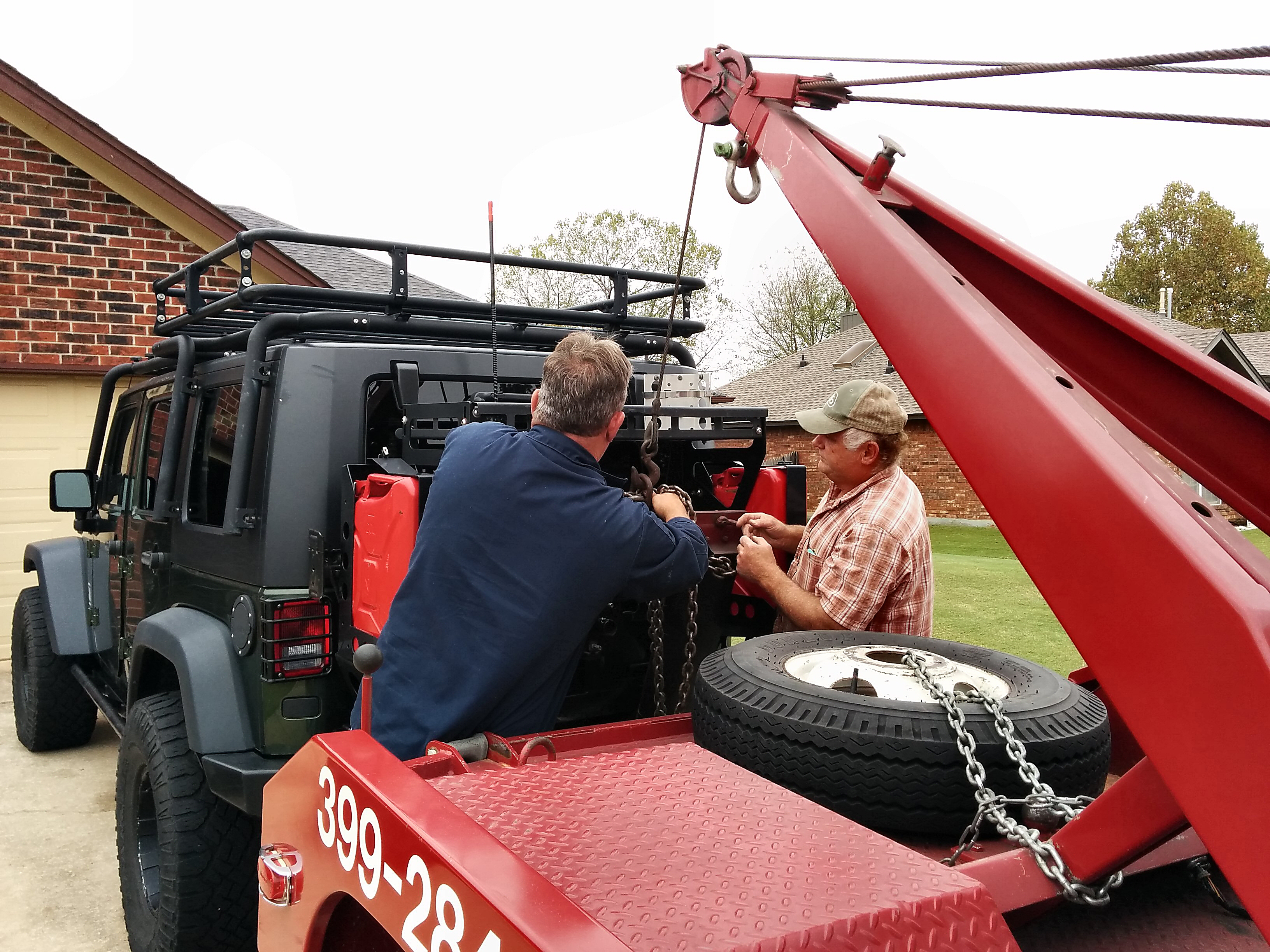

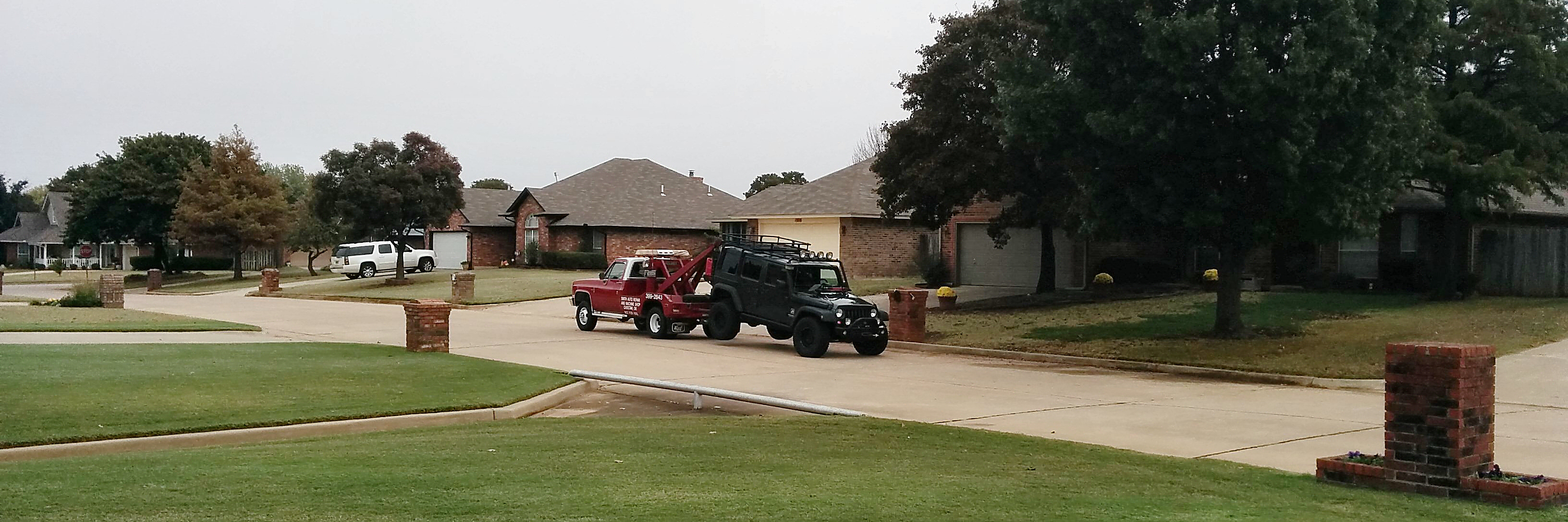

Hooking up the two truck. Pulled the spare to provide clearance. And, as mentioned, front driveshaft to protect trans/transfer case.

Mark that picture of your beloved Jeep being towed down the street is one very sad picture.
