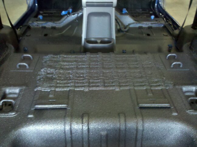

ID:	340042 did mine over a year ago going to do the exterior here soon..

Originally Posted by USCG-JK
Attachment 340042 did mine over a year ago going to do the exterior here soon..
Looks like you did a good job.
That would be cool to see one totally covered in Raptor. Make sure you post it when your done. I've seen people do it with Line-X and Monstaliner before but not Raptor yet.

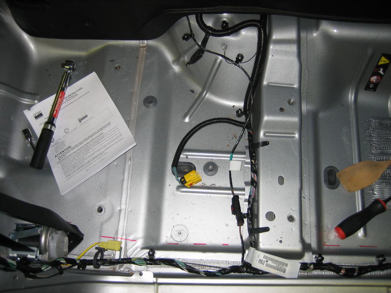

When you guys did your two doors, did you mask off the loops for the rear seats or did you line over them? Did you have any problems with reinstalling the seats? Did you put the plastic trim back in (around the doors and seatbelts)?
I lined over them after asking myself in this thread -->https://www.jk-forum.com/forums/jk-s...ner-jk-236549/ . I personally only use the seats like a week a year and haven't put them back in yet.
EDIT: After putting the rear seat back in, it chipped a small price of liner off. I think it is a bit harder to get the seat also to lock down( but possible). I think I would mask the loops were it attaches.
Originally Posted by vulcan classic
I sprayed the seat mounting points and seat release bar/catch works fine!
Yeah I reinstalled it. I used a red permanent marker to trace them before I removed them, so I would know where I needed to spray to (pictured below). I guess you might be able to get away with useing a wire loom around the wire bundles by the door sill (bottom of the door). I think it would end up looking bad personally. The christmas tree plugs for the plastic peice near the door sill cost about $3.50 a peace at the dealership . I probably could have re-installed mine but I end up getting 6 Ford aftermarket ones at Lowes that did the trick for $1.20.
PASSENGER SIDE FOOTWELL
I didn't spray any on the right wall in this picture below. The plastic piece goes up and over the calk line.
On the driver side there is not a wire bundle from the dash to the front of the seat as shown in this picture. Just a tube for the rear windshield wiper fluid. There is a wire bundle that goes under the driver seat and then back to the rear.
