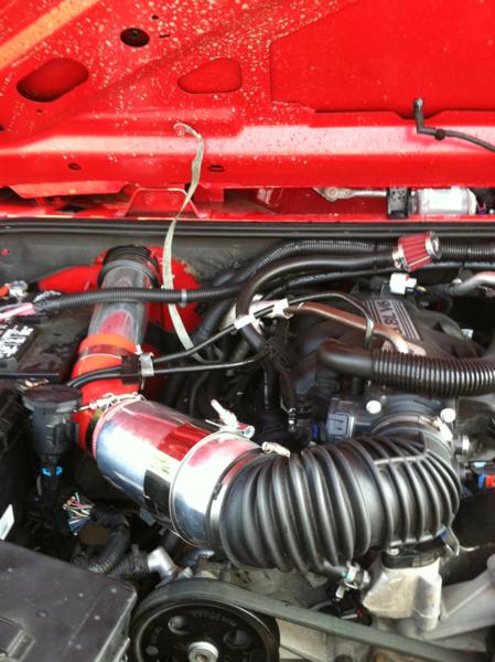

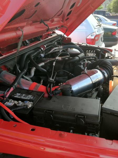

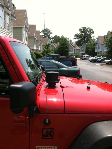

Installed my spectre performance in-line airbox, which allowed me to put on my Donaldson TopSpin pre-cleaner.... PROJECT COMPLETE
hmmm... I like it! without the use of the stock airbox you could still potentially run a dual battery set up. Where did you get the inline air box from and how much was it? you noticed any mpg or horsepower improvements?
Old Jun 21, 2011 | 06:25 PM
  #35
Battlefrog's Avatar
Posts: 3,449
From: Newport news, va
The in-line airbox was purchased from racemart.com if I remember correctly. I originally found it on spectreperformance.com for $90 but found it cheaper at racemart for $59... I could def run a second battery if need be, but I installed an ammo can in the factory airbox "slot" for my winch stuff... I have notice about 1-1.5 mpg increase and some power as well. It has a low throaty sound to it during acceleration and pre-cleaner sounds like a turbo.... I just put 35's on so I'm probably gonna notice a decline in mpg; hopefully to what I was averaging before (15-15.5).... Here is a pic of ammo can....
