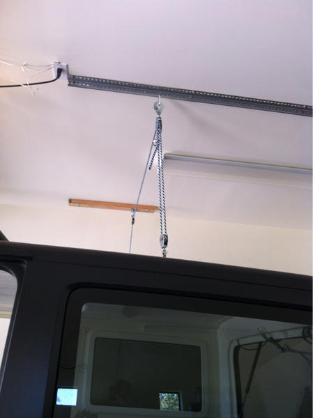

No write up yet but here is mine.

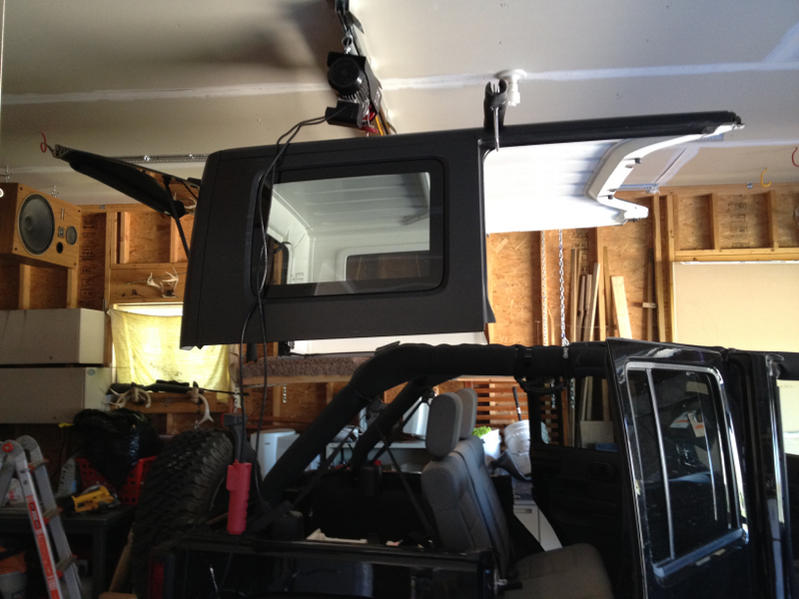

Just got mine done last week. I went with an electric hoist mounted to a 'Shed' door track so I can slide it to the side of my garage. Best part is I can remove or replace the top within 15 minutes by myself!!!!

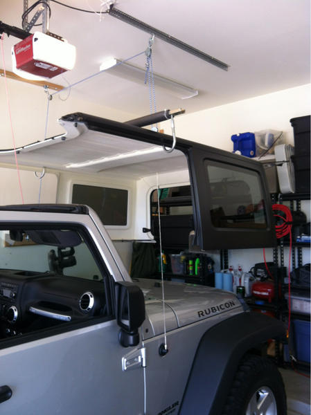

Pics of mine, awesome write up, thanks

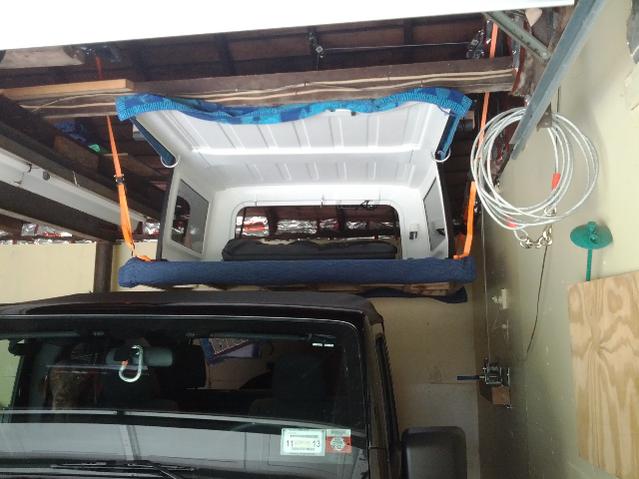

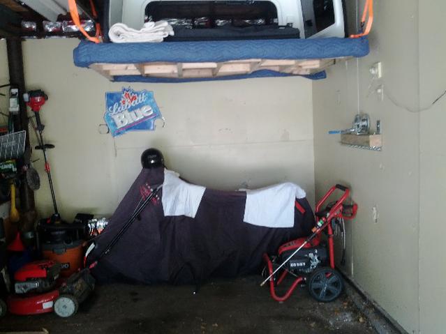

I finally built the shelf. I lined it with a moving blanket. I may still run a second source of support to ensure it didn't fall. I don't want it to fall on the Jeep, my wife's car, or my Harley.

What did everyone use for their hooks in the ceiling and on the platform?
