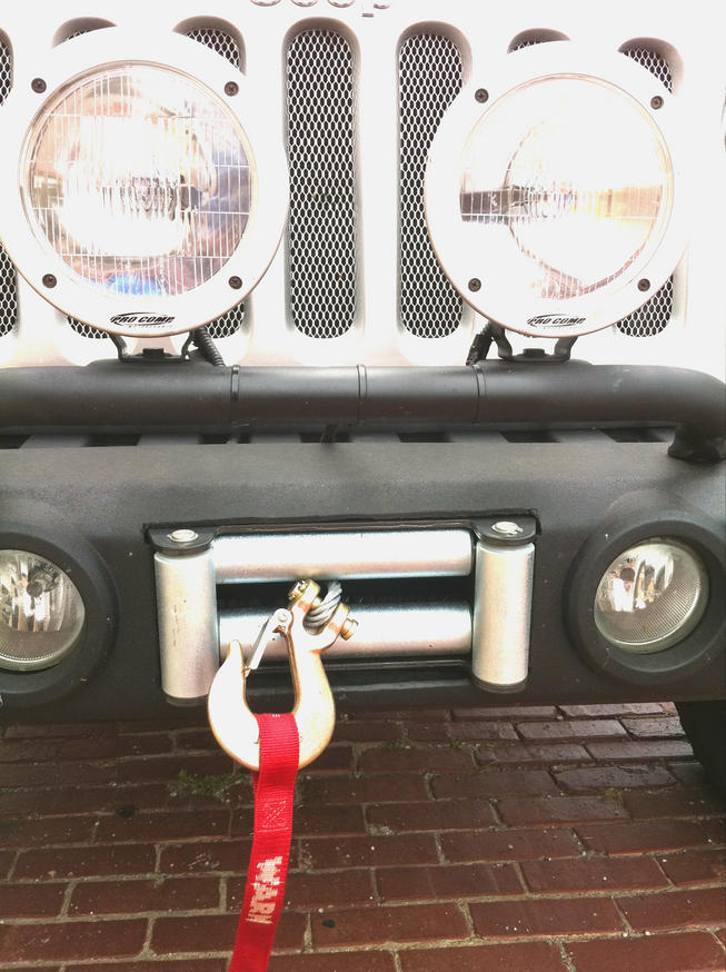

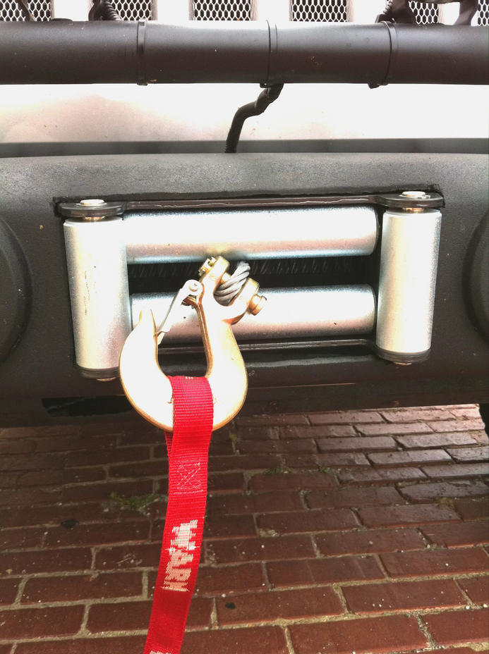

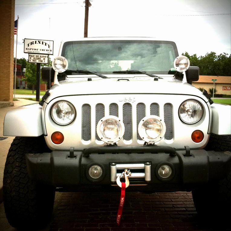

Here's a few shots of how mine turned out. I think it looks great the chopped bumper. Also, I was able to install the Solenoid box on the frame rail behind the bumper on the drivers side, it's easily accessable there and I like how hidden from plain sight it is. Let me know if you need more pictures.

Looks great on all accounts - couple questions.
1) Appears to work with fog lights but when I pulled mine apart to look, looks pretty tight? I guess I am going to try to do same thing with aftermarket bumper (orfab stubby), so maybe the lights are slightly different location.
2) Biggest question is does anyone have this done with a 10k winch? Are they any bigger than the 8k or 8.5k winches? I am guessing a little bigger? Is there clearance for a 10k?
If so, I am going for this... I think it might even be easier wiht my ORFab b/c I can mount the fairlead directly to the front of my Orfab and not need to 'space it out' so it mounds solid.
Thoughts?!

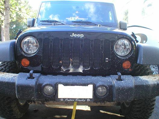

Tell us more about the license plate piece please.
Originally Posted by roddogg
took the best out there and put on my twist . I wanted a stock looking front end which included the required front license plate Attachment 4015 (the area that look like a dent on the bottom of the grill is just the flash) I wanted easy access to the winch but didn't want to block the rad. with the soleniod to avoid a over heating issue Attachment 4016. I moved the soleniod beside the battery Attachment 4017 I ran new cables from the solenoid to the battery and winch. Auto part stores carry a large selection of battery cables with the right ends to hook up the battery to the soleniod and the soleniod to the winch. I used a trailer 4 wire wiring harness (removed 1 wire as its not needed) from the soleniod to the controlled hook up. I placed the trailer wire 4 plug hook up connection behind the grill to make the removal of the grill easier and place the controlled connection through the grill inserts to finish it off.
Hope this gives others ideas on making mods your own.
Thanks to all for the direction and I hope this helps someone else with thier project.
Mine pictured above is a 10,000# winch. It fits just fine.
Attachment 74745Attachment 74746Attachment 74747
That looks fantastic!! Nice work.
I would love to see some more pics of how you have it installed and if you have any pics of how you did it.
Thanks
