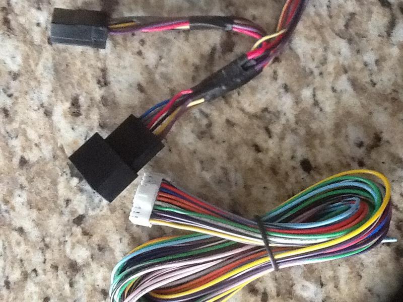

  #167
jmill012's Avatar
Joined: Feb 2010
Posts: 84
From: Manchester, MD
Originally Posted by Woodbutcher
Jill. There is a yellow wire should be right next to a purple in the t5 harness, this is the one you will be plugging in to jeep harness. Then there will be one in the 20 pin connector, the one with 20 wires that will be plugged into the evo all ( black box). Splice them together.
Ok so the yellow wires in these two plugs?
Old Feb 13, 2014 | 11:59 AM
  #168
Woodbutcher's Avatar
Posts: 98
From: New York
Make sure your getting the same setup as everyone else, not sure if you saw my edit above.
I used 4lo and Neutral to test the system..my plan is to use a relay. pin 86 is your key on hot, pin 87 is your ground output that goes to clutch, I want to switch this as well. 30 and 85 go to the e-brake, or 1 to ground and 1 to brake.
Old Feb 13, 2014 | 12:03 PM
  #169
Posts: 98
From: New York
Attachment 530700
Yes,
In the t5 harness the long one, there is a yellow right next to a purple. I think they were the longest in the harness. then there is a yellow in the 20 pin.
Old Feb 13, 2014 | 12:05 PM
  #170
jmill012's Avatar
Joined: Feb 2010
Posts: 84
Yes,
Perfect! Thank you!!
I almost spliced the wire on my Jeep harness and then realized everyone said it wasn't on the Jeep harness.
