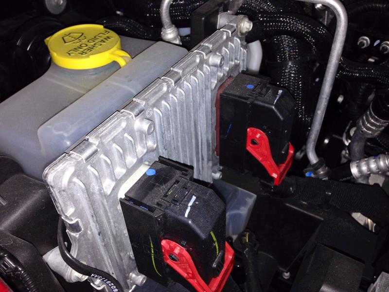

Just to confirm this is the PCM correct?
I will disconnect neg battery terminal and no key in ignition while removing. Click image for larger version
Old Jan 3, 2014 | 06:29 PM
  #59
karls's Avatar
Posts: 2,873
From: 36* N
Yep, that's your PCM.
