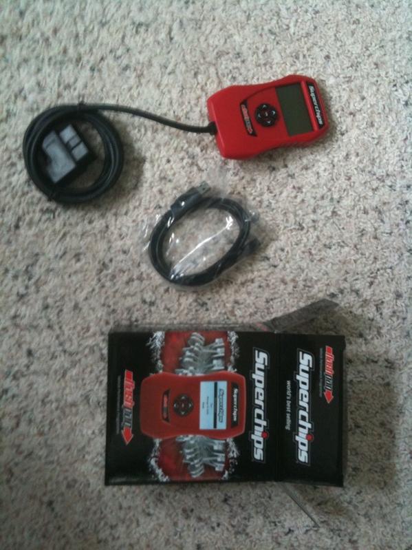

Look what just arrived.....
Just got the updates installed. Will test it out tonight. Intake and exhaust is next....
