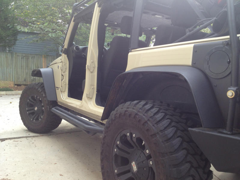

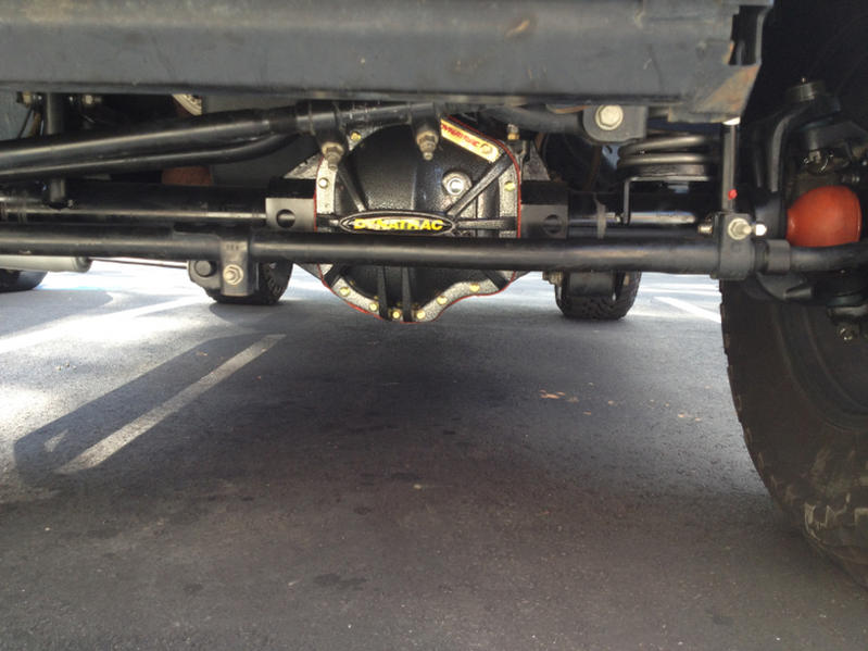

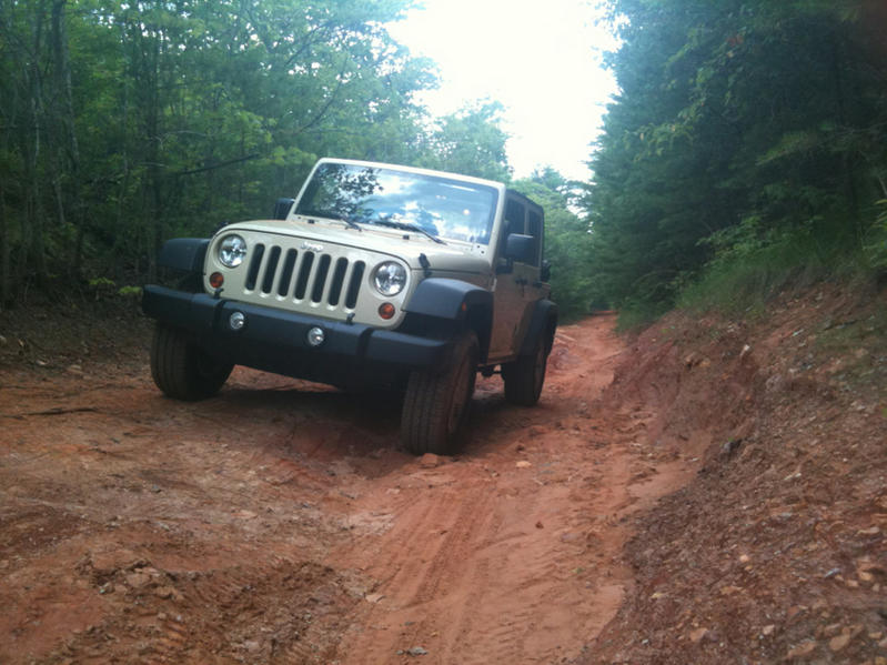

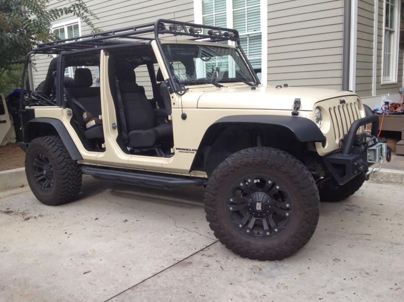

I went straight to 35s from stock. Just got my prorock 44 with 5:13s and couldn't be any happier.

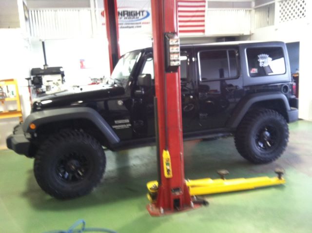

Agree with this. If you want 35's, get the 35 X 12.50. As mentioned, if you go with a 315 / 70, it's closer to a 33" than a 35" + noticeably more narrow. I wheel with a guy that didn't realize this. Upgraded from 33" to 315 / 70. Then 3 months later upgraded to 35 X 12.5. 325 / 70 might be a good option if you want the metric, more narrow size. However, not many tire manufacturers make this size.
Btw, I bought my 33's in a black friday sale last year and upgraded to 35 x 12.5 x 15 a month ago. It was a huge relief to correct my original mistake.

Nice, what kind of lift are you running there?
