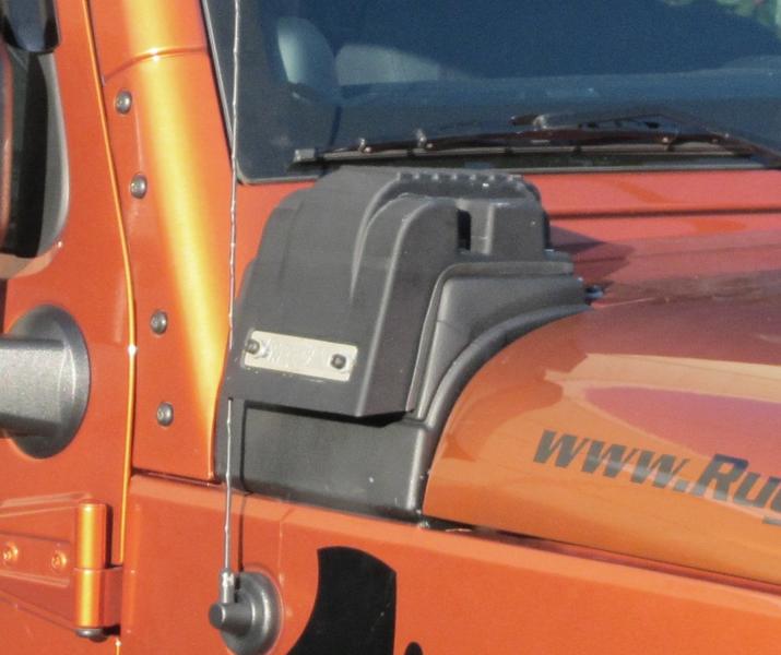

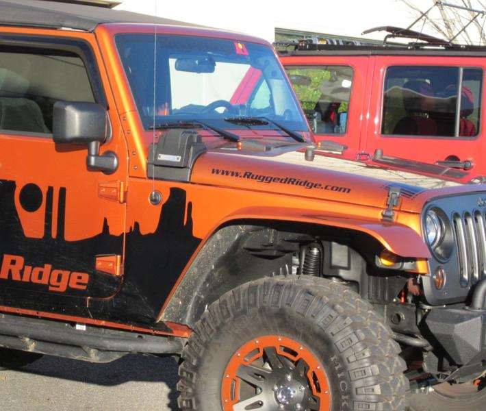

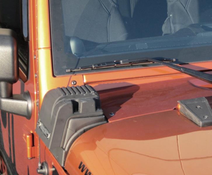

Well your timing is good... We will be doing DYNO runs this week. Hope to have the data to you guys by the end of the week. We have done final (conditional) approvals for about 75% of the kit. Still have a few final (quality - appearance) issues to finalize for the other 25% and hope to have final approvals for production very, very soon. To give you guys an idea of how things can change and delay things we just had to do a final last minute revision to the shape of the low mount intake. This has everything to do with function over form. We pushed hard all the way to the end to have the low intake designed to allow the windshield to be dropped. Well it looks like that wish list item had to be removed. We found that we were at the very lower limits of air flow through the low intake and we just did not feel comfortable with the small amount of wiggle room it allowed. Attached is the reworked intake. It is higher but has twice the air flow than the original design.

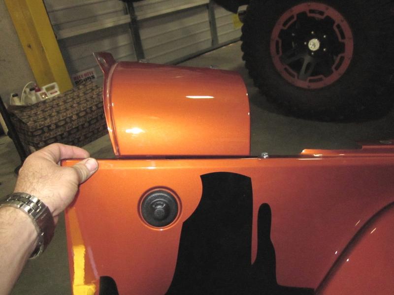

Now I have not gone out and removed the windshield frame bolts and dropped the glass yet. Its close but I just have a feeling the curve of the windshield will not be enough to allow it to sit flat on the hood bumpers and clear the new design. We have also included images showing the cowl remounting bracket and how the cowl can be put back to stock if needed..
