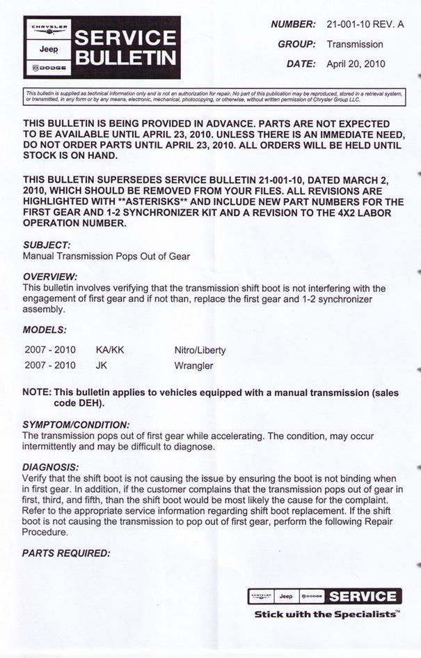

Hey everyone the tsb was revised yesterday... mine is at the dealer as we speak for this.
ID:	62252Click image for larger version
ID:	62253Click image for larger version
Nice ! I've sent this TSB to my dealer, waiting for news. Mine has a new tranny ( replaced ) and I want to be sure that the new synchro is inside.. better be safe than sorry. They'll do the TSB upon reception of the parts.
Thanks man for the revised TSB !

This revision sounds like THE fix to me.
