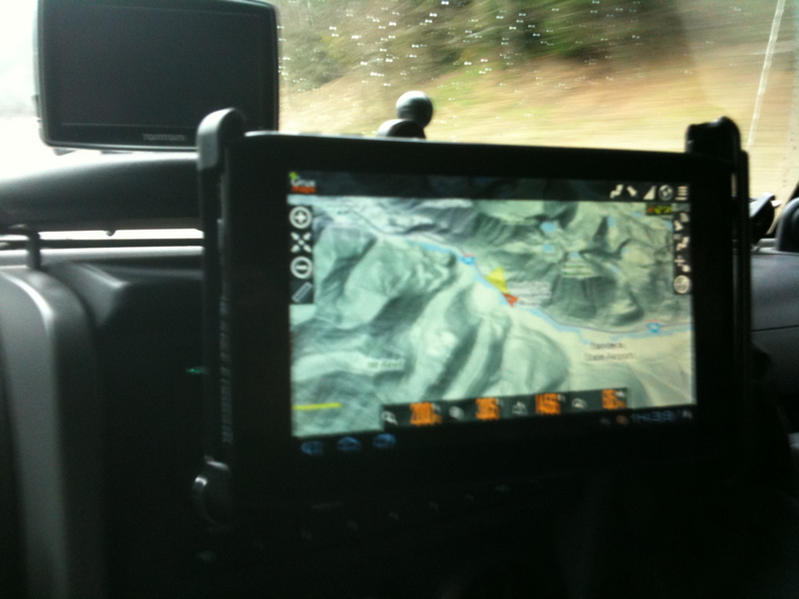

Good topo maps are a primary need for overland/expedition travel. I've recently installed a Nexus 7 into my Jeep with the BackCountry Navigator Pro software (and some other goodies, too). Here's a video of that install and how it works--parts list is linked from the video description. I apologize in advance for the quality of some of the sound--it was windier than I thought (note I had to change hats!), and for some reason my GoPro was picking up a vibrating noise.
YouTube Link: http://www.youtube.com/watch?v=k6UolIlksZs
Cool setup. Looks like mine, except I hang the RAM mount on a Vector's e-dock.
I use OruxMaps. It runs on Android and it is awesome. I've been using it on my Acer A100 and it runs flawlessly. The 7in screen size is perfect and the software fully supports touch.
One thing I like about it is that it is possible to download free topo maps from Google, USGS or others and use them offline just with the tablet's embedded GPS. It can log the track and then export it so we can create backups or share it. There are tons more of features.
Another great thing is that it's all free. There's a voluntary contribution fee to the developer, with is more than worth it. ;-)

Not many details actually. It's a quite simple installation. I posted about this setup on this and a couple other threads last year after testing it. I can also install and use Windows-based UMPCs such as the Viliv S5 and Fujitsu U-820. However, the Acer + Android offered the best UI IMHO.
Main steps were:
I got the Vector e-dock because of the flexibility since I already had an idea of what I wanted.
The most difficult part actually was selecting the RAM mounts. Too many variations to choose from. Some folks in this forum advised to check gpscity.com and their website has tons of good info and advice, which helped quite a bit.
I opted for the Acer A100 tablet because of size and features (SD card reader, embedded GPS, Android operating system, touch-based UI, price, etc.). It is running Ice Cream Sandwich.
Some research led me to a couple GPS software that could handle topo maps. I found OruxMaps by far the most flexible and feature-rich. Mostly because it allows for downloading Google Maps (topo, street, Google Earth), USGS and several others for offline use. It also lets you saving the GPS log and export it to view in other software or sharing with friends.
For music I use Acer's Media Player and still looking into the ECU software. Superchips released an Android-based software that worked well on phone's small screens but messed-up on the A100's 7in screen. Still waiting for a fix and using the Bully Dog right now since I want the ability to tune the Jeep's ECU.
Let me know if you would like more photos or details.
