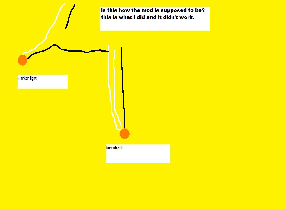

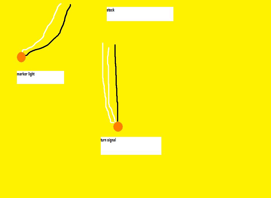

Someone please look at the pics and tell me what I did wrong

Old Feb 18, 2009 | 04:41 PM
  #90
Posts: 24
From: Central, AR
right concept KMB: the black wire from side marker bulb to the outside white wire on the turn signal. i would say double check where you have spliced the wires together. otherwise you have done everything correctly.
can you take some actual photos of the connections?
