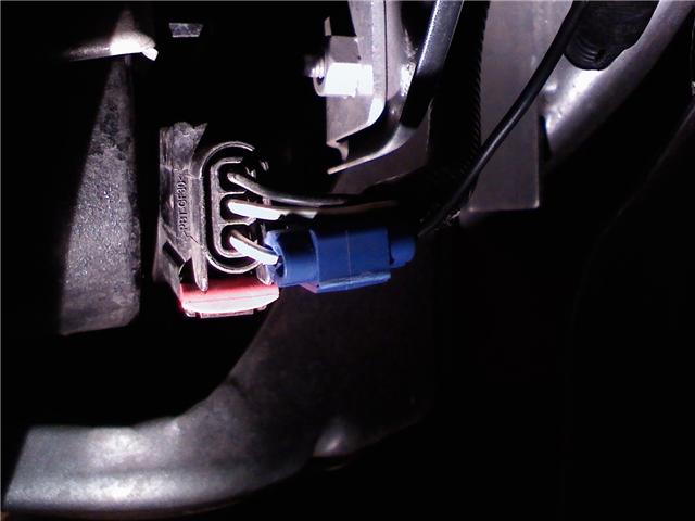

Default pic of mode
Name:	marker light mod.jpg
ok heres a pick of how the wires should be it just took me about 15 mins and that included getting the tools out.
cut the black wire (from the side marker) about 1.5 inches from the plug that is behind the grill (not on the fender)
then get the scotch lock and connect the black wire to the front grill turn signal light the white wire furthest from the black [three wires - black, white w/stripe, and white w/stripe(connect to this one)]
