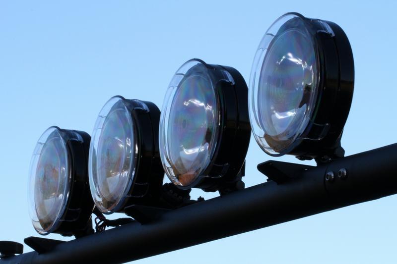

So, replaced with these polycarbonate rock guards that provide better protection ...
Attachment 412716
Mark,
Do these create any extra glare? I have seen a lot of lights (like Light force w/ polycarb protectors) create more glare when such protectors are used. I don't think it would be an issue with your set up, but could see it being an issue with windshield mounted lights or lights right above the windshield.

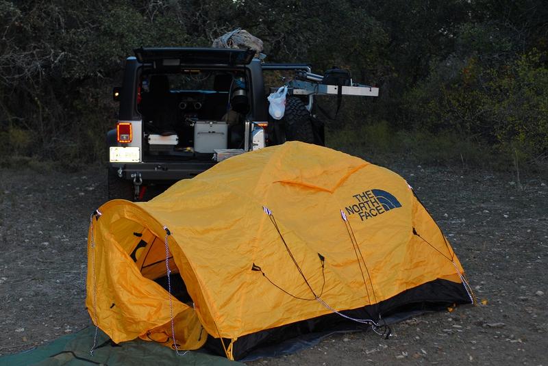

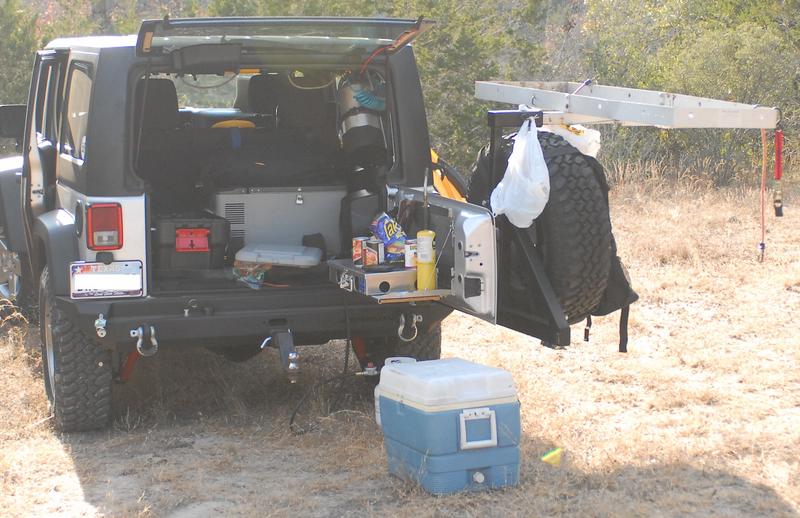

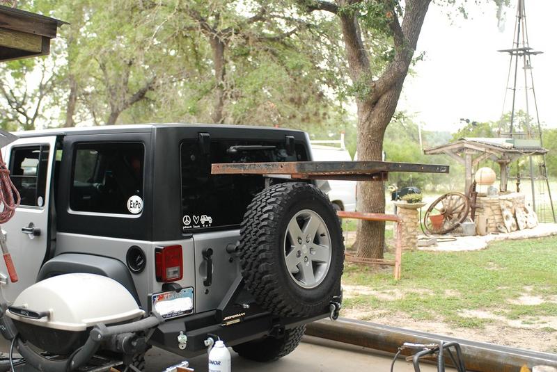

I carry stuff occasionally on a rear carrier. The first trip out in the jeep with the carrier on the back, I was SOL when I had to get into the back to fill the cooler with ice. Had to unload my canopies etc to get into the back. The next weekend I broke out the welder and some tubing and got the carrier up and out of the way. I figure if the swingout was designed to handle (2)5gal cans of gas and a 37" tire, a 100lbs of gear on a carrier should be fine. I think the most I have had was about 50. Does kill the rear view mirror, but that's what a rear camera is for.

The last pic, you can see(sort of, had the damn ISO up from the night before) the two 1/2" set screws to keep everything from rocking, one on the receiver tubing welded on the swingout that holds the 90 degree extension. The other on receiver tubing of the extension that the carrier slides into. The setscrew on the extension makes for a quick trashsack holder when not carrying a trasharoo.
Hadn't thought of that, but it's a good point: Working at the back of the Jeep, which is my kitchen area, would be a problem unless that rack were removed when camped.
